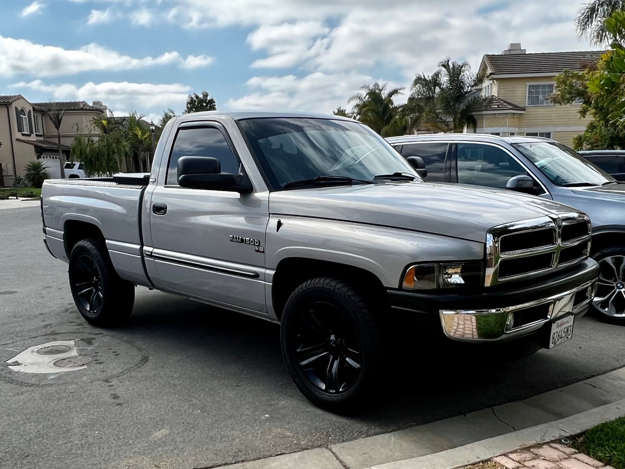

Seems I always end up joining forums for any vehicle I own! Anyways, I’ve owned this 2001 Single Cab for a few days now. Such an awesome truck! Loving it more every day.
Has a healthy 5.9 Magnum backed by an auto trans which I can only assume is a 46re? Healthy readings from all the gauges. Nearly everything works on this truck. Power windows, mirrors, AC almost works perfectly! Which leads me to my first concern for the truck. Granted, it’s 22 and it’s not going to be perfect (nor do I expect it to be.) However, I’d like to keep this as my forever truck. So I’d eventually like to get small problems like this squared away before they become big ones! Truck has been a California truck for its whole life. It’s lived in nothing but dry environments.

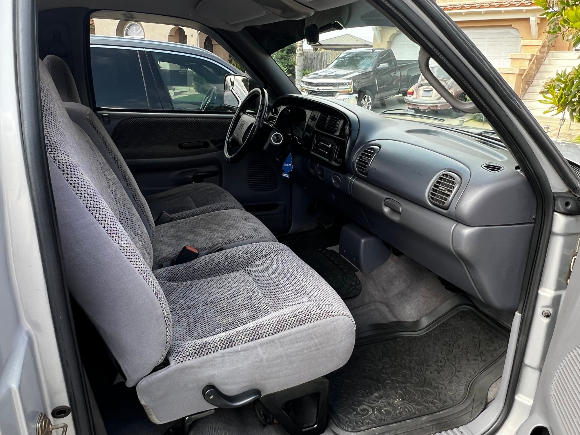

Interior is CLEAN!

Thumbs up Great pics!
Beautiful truck ya got there. Looks like it has been well cared for. Good luck with it.
