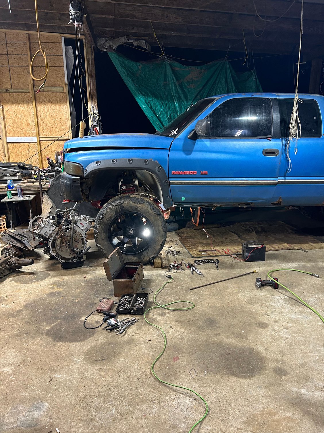

I have a 96 5.9, to start from the beginning truck was fine only issue I had was sometimes you’d have to hit the gas when cranking up to get it to run. Driveshaft fell out and when it did ripped 4 wires out from the bottom, We took it took the shop & had it fixed. They also replaced “ecm”, u joint and yolk. 4k just for that. Then we had to tow it home, come to find out transfer case , & transmission was out so we replaced those. We’ve replaced Crankshaft sensor,camshaft sensor, pickup, tps, coil, cap, rotor, fuel regulator sensor, checked spark plugs, checked injectors, cleaned IAC valve, cleaned throttle bottle, changed the oil and filter. Now it will crank but idols rough in drive it’s like it loses power trying to accelerate. Will go into reverse and move no problem only a little bit rough idol. We have tried everything we can think of, we probably have replaced more than what I listed but that’s all I can think of right now. Open to any suggestions or ideas
also to add- when in drive the rpm gauge goes up and down then shuts off, and stalls but cranks right back up every time
