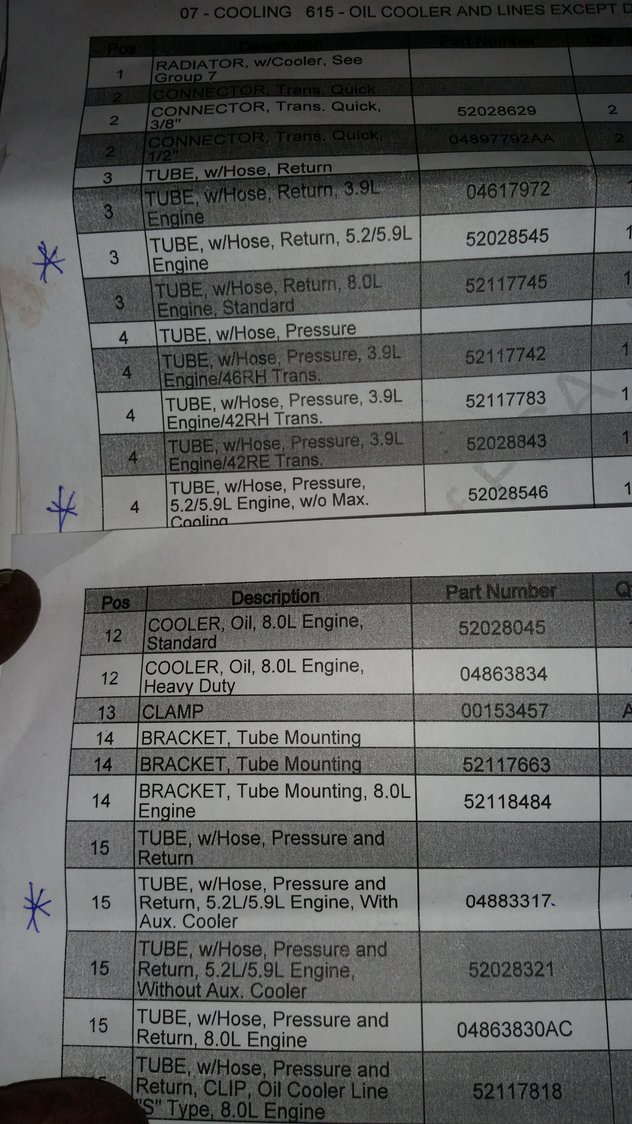

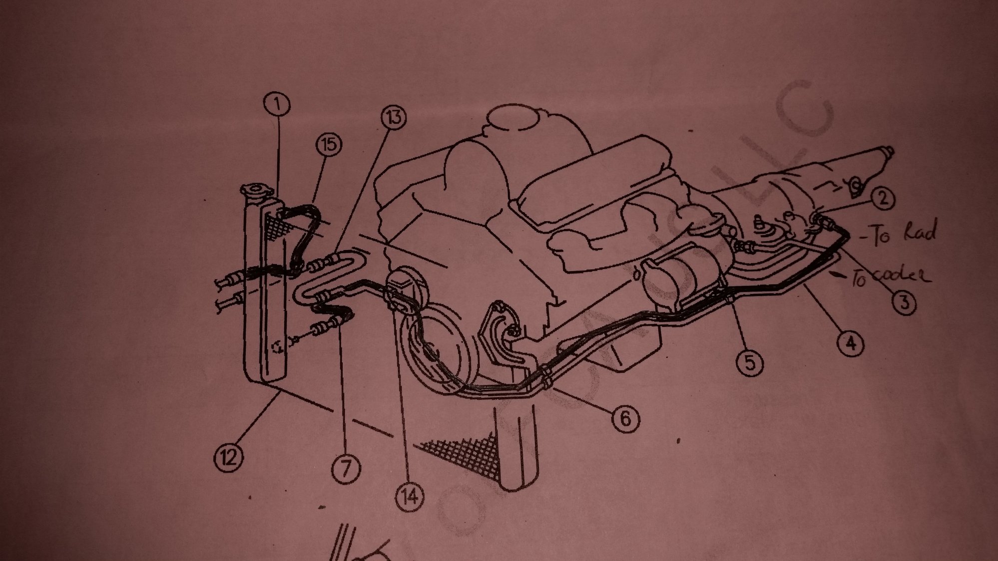

#3: 52028545
#4: 52028546 (replaced {?} with 52028670AI {is there maybe a service bulletin about that?})
I have the pdf. The attached printout is from Chrysler.

Do you happen to have the old lines? Do you need these lines right now and do you want new or used? If you have a pick and pay yard in your area, you can likely find them on a 2nd gen truck. If you have the example lines to use as a guide, you can take them to a professional auto parts store (NAPA, etc.) or a hydraulic parts/hose supplier and have those hoses made up for you.
If you're hell bent on finding the OEM hoses, you can establish searches for those part numbers on eBay to notify you by email when those part numbers show up, however, that might take some wait time.
