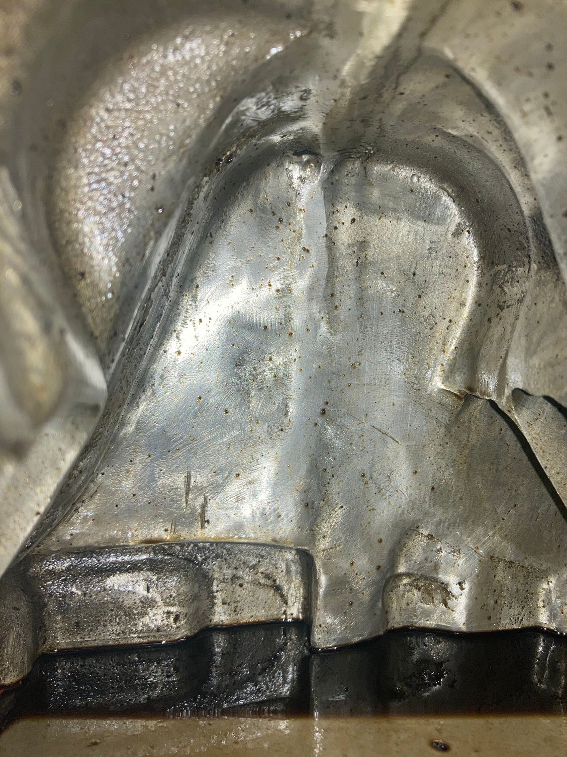

Quick update for you all. I took the throttle body off cleaned it really well I shined my light inside the intake manifold and noticed small remnants off oil inside near the front and middle of the intake. However inside in the back of the manifold there’s a small pool of oil. Is this normal? Also I changed my pcv valve and grommet (which was cracked) a few days ago as well. Thanks!

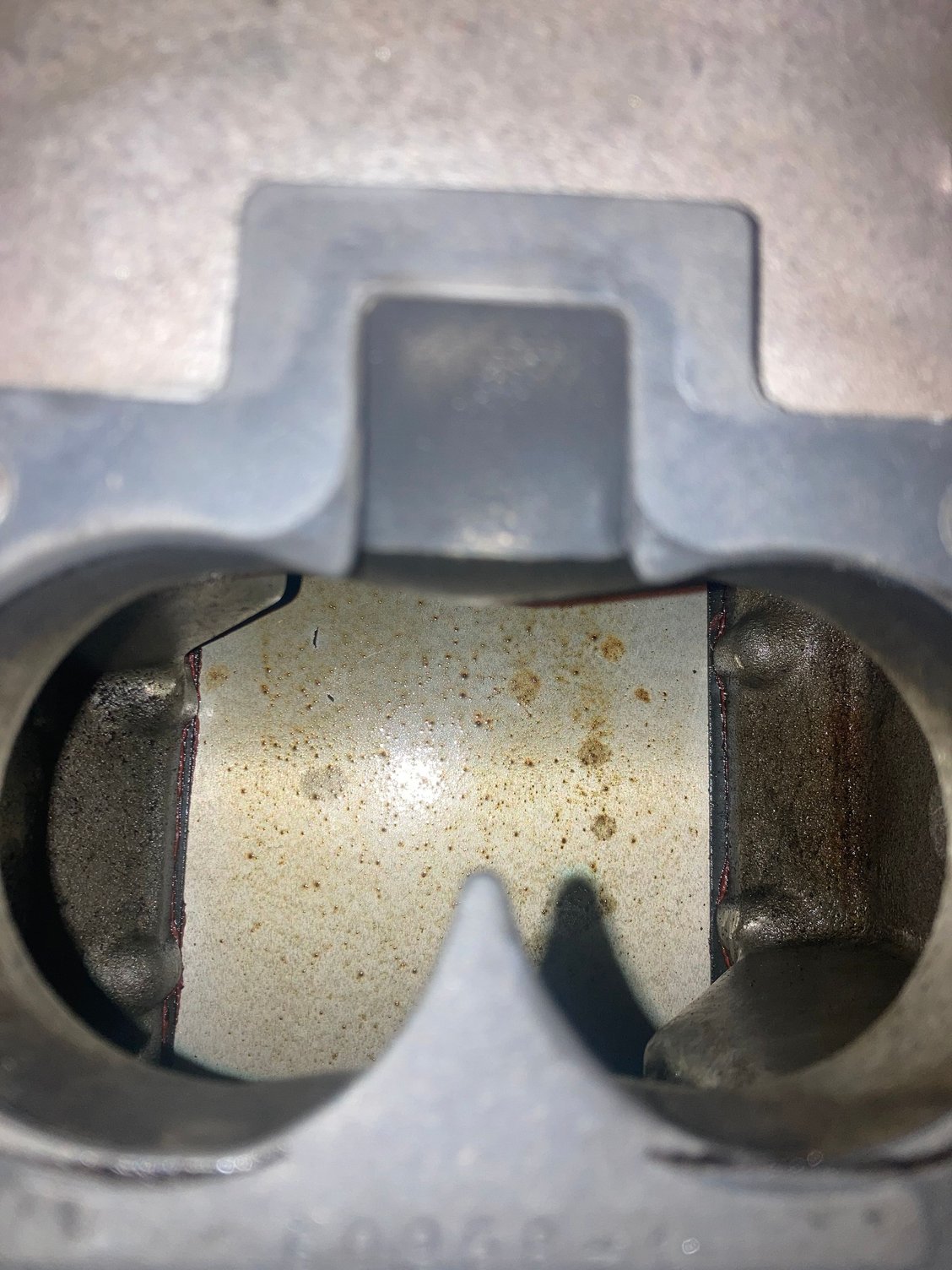

I've included pictures of what I'm seeing. The first is looking straight down into the intake manifold. The second I stuck my phone down inside the intake manifold and used the flash so y'all could see the small pool of oil inside the intake manifold. Any ideas??

If oil is pooling in there, either the gasket is blown, or the PCV valve has to high of a flow rate..... The gasket being bad would give you a nice vacuum leak, and account for your unstable idle.
This is the plenum gasket you're referring to?
Old Dec 9, 2023 | 10:44 PM
Posts: 87,562
Likes: 4,231
Yep. The gasket between the aluminum manifold, and the plate on the bottom that seals it.

I see spots on it but no "pools of oil".
We replaced the plenum a little over 3 years ago
Did you use a fel pro gasket and lock tight the bolts in?
