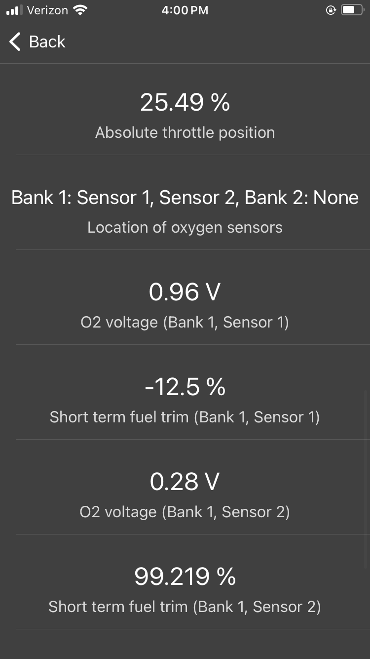

I really need some help. I've been a reader of this forum for a few years now and have learned a great deal about our 'beloved" 2nd gens haha. Recently my 1996 Ram 1500 4x4 5.2l began to idle up and down constantly while stopped or in park. This isn't the first time this has happened. I have changed the tps, iac and maf sensors numerous times. Just recently I changed the IAC and TPS (Standard brand) along with new O2 sensors (NTK) hoping that would solve the problem but it did not. I chose NTK btw because I read on here that those O2 sensors were desirable for 2nd gens. I have cleaned the throttle body, cleaned the air filter, put a new throttle body gasket on as well. A little over 3 years ago we installed the hughes aluminum plenum because we understood the issues associated with the stock plenum. I am at a loss. What would be the next steps to take to help take care of this idling issues? I followed some of the vacuum lines but they didn't look in bad shape. Any help would be greatly appreciated!! Thanks!!
Also, I have attached some photos of some data that was pulled from an OBD2 scan. Hopefully this helps!

700 RPM at 25% throttle? That ain't right.
This is the data I got while in park. When I checked for any DTC codes it didn’t pull any.

Long term fuel trims are kinda high. I wonder why it's trying to pull fuel?
