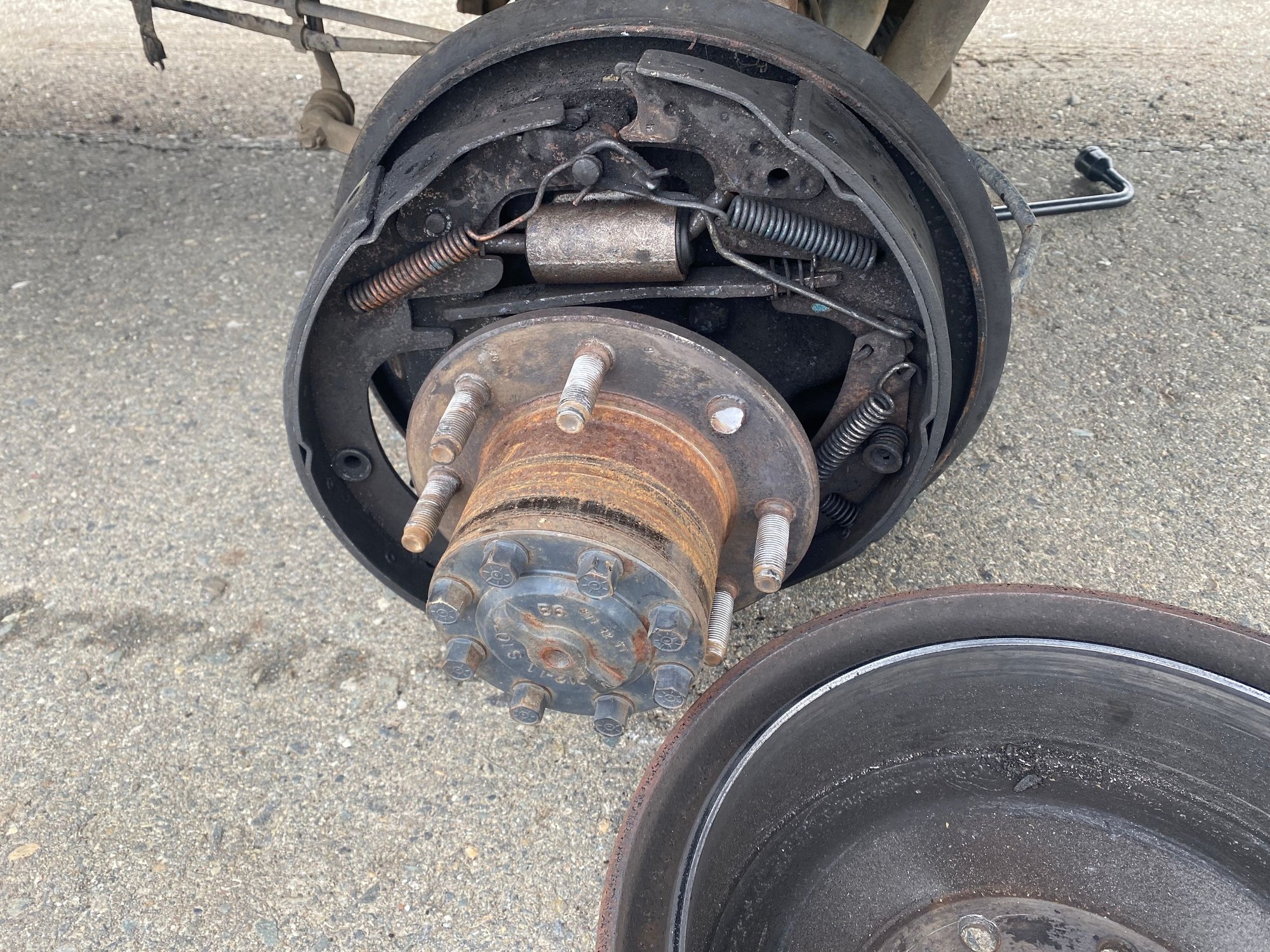

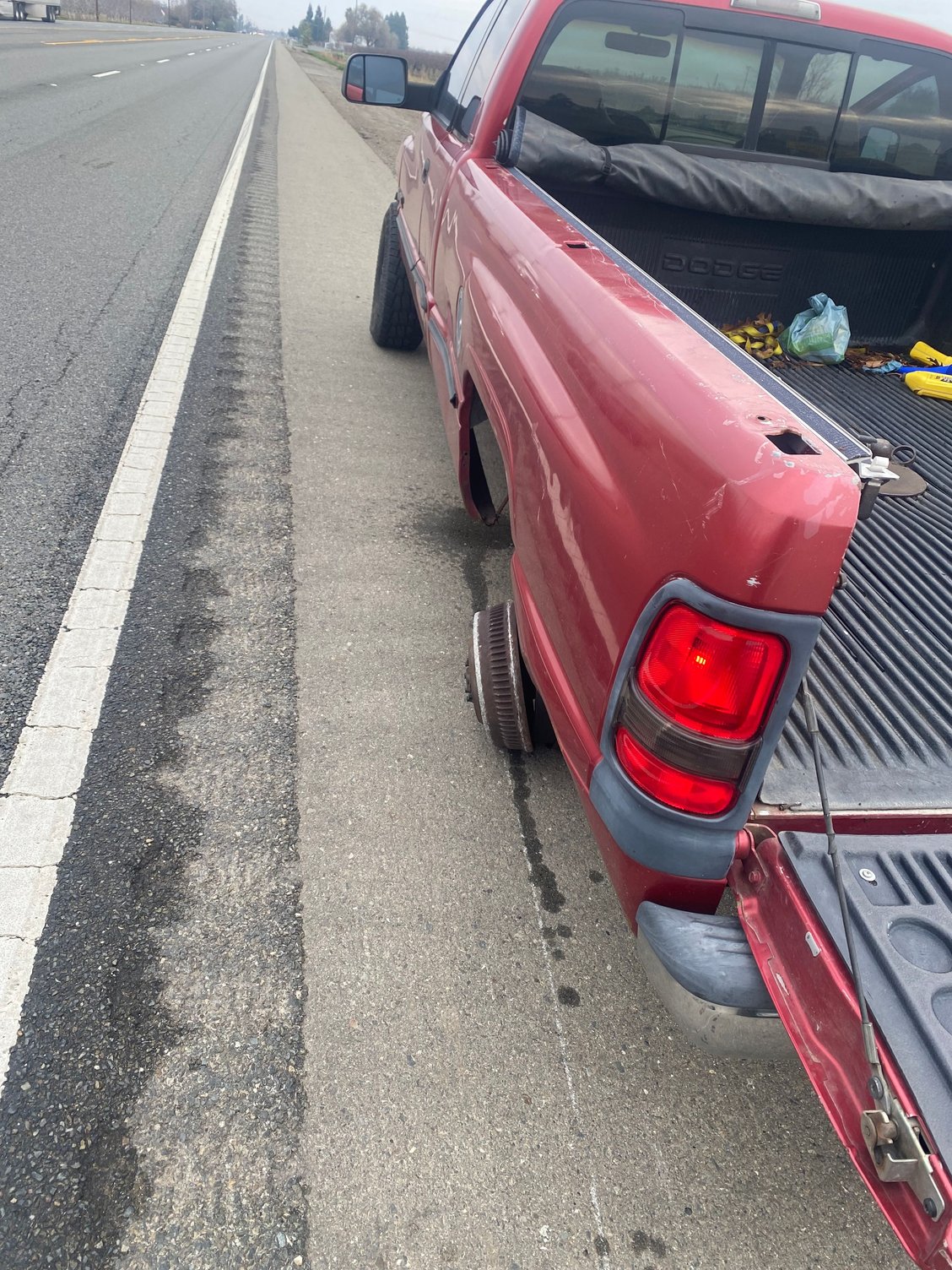

Wheel flew off while driving. Luckily nobody got hurt. Not really sure how this happened.
Wheel hub is done as well as drum brakes. Looking for parts recommendations.

Weird. Running a wheel spacer by chance?
Is the wheel hub really done or does it just need new races, bearings and a lug stud? If needed, should be able to find another hub off a rear diff at a pick and pay salvage yard..

I would expect the hub/bearings are likely just fine. New studs/nuts are definitely in order though. I might be tempted to replace the drum as well.

From the looks the nuts came off and the drum was riding on the hub. How did you not hear/feel this? You may want to check all the other lug nuts as they may be loose also.
