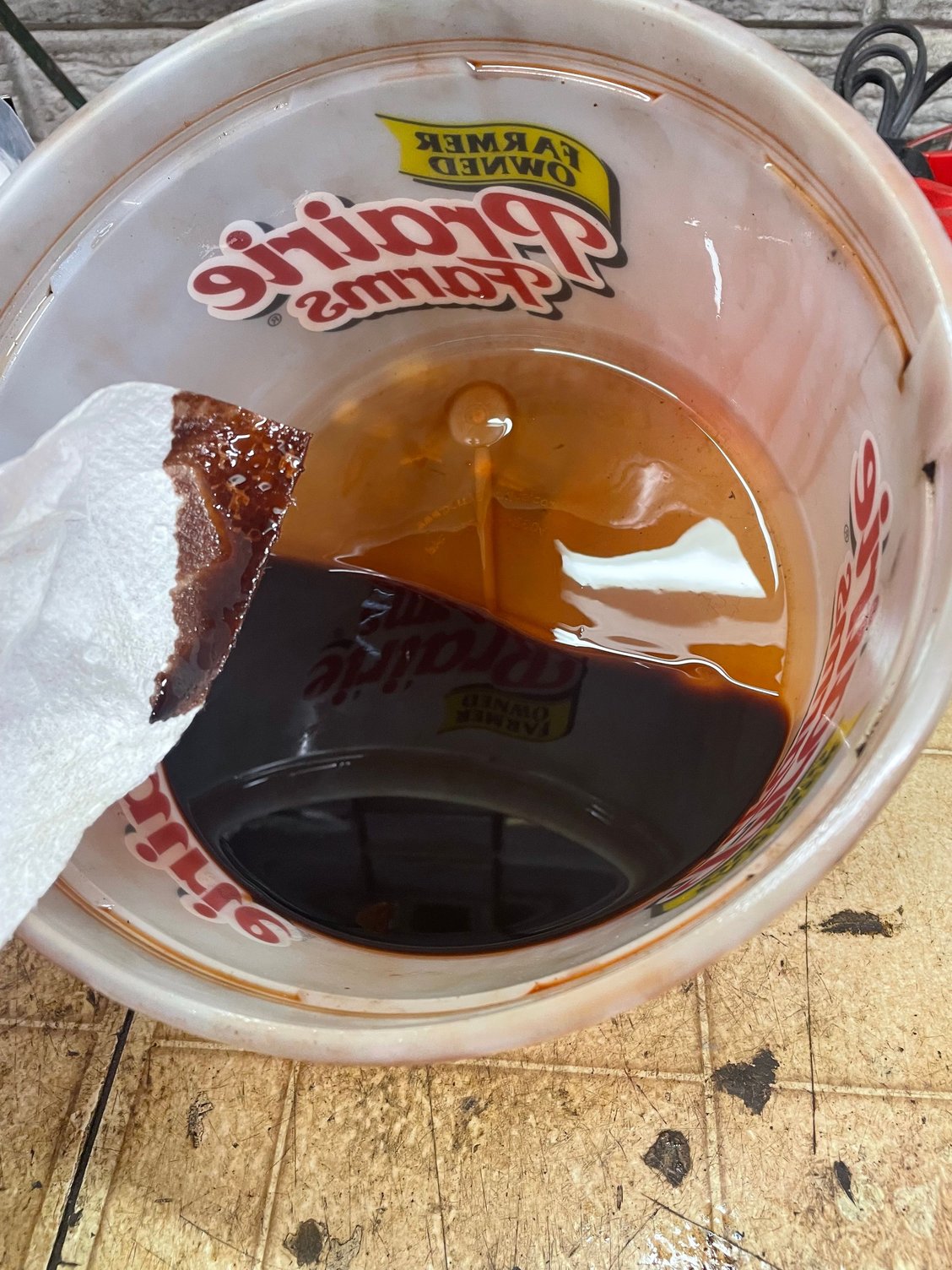

What will replacing the fluid do? Do you think the snap ring is something I should check on or replace?
Checking it would be a good idea.....
The fluid that's in there now is ugly. Needs to go.

I changed the fluid. No change in the performance. I think I’ll have the shop take care of the transfer case. If it goes beyond the snap ring I’m in beyond what I’m comfortable with.

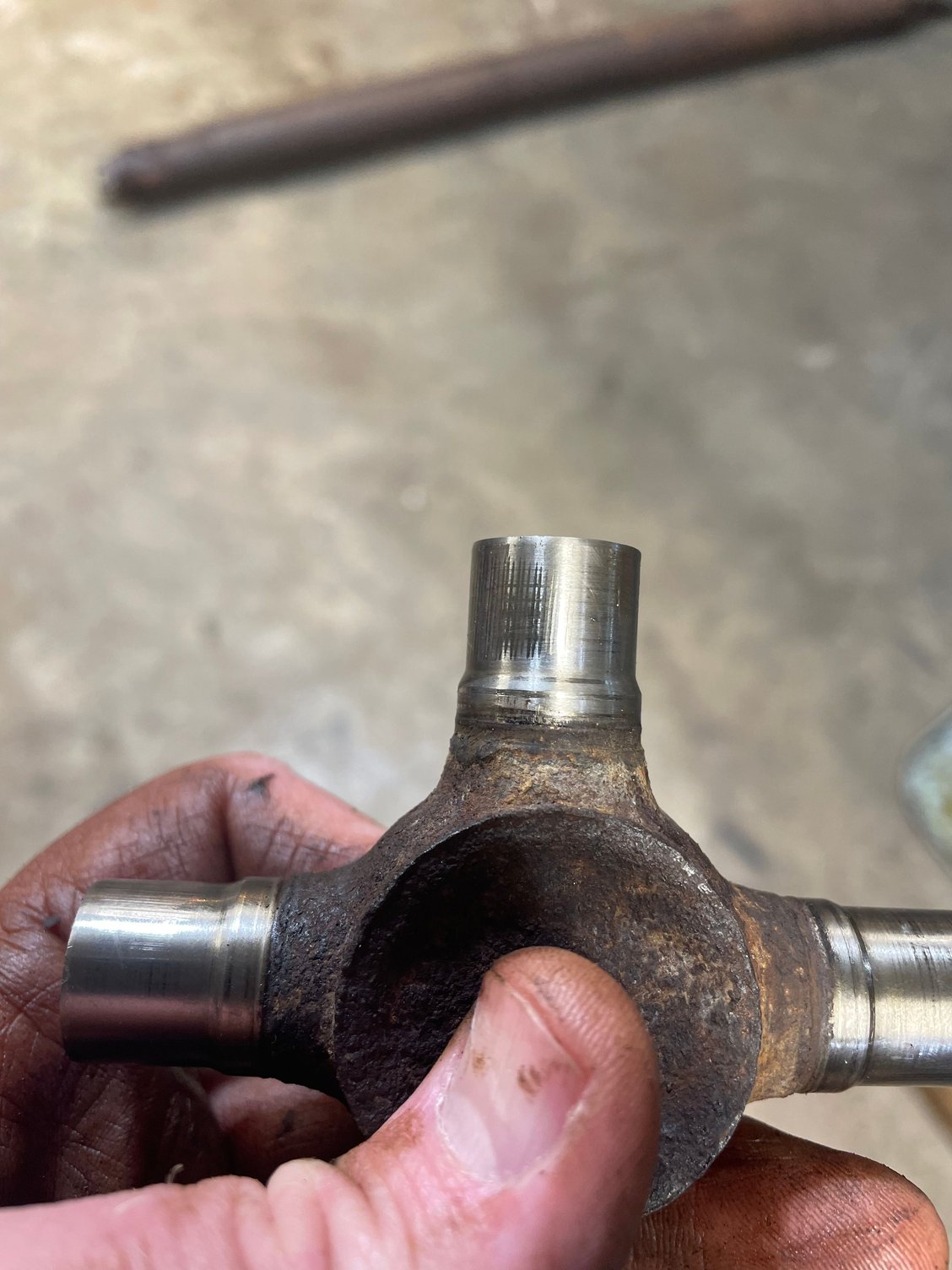

Update to my issue:
I had my transmission guy ride with me and he said replace the rear u joint. Though they moved well in the yokes upon my inspection they had grooves on the spindles (see example image). I replaced both. I would not have thought it was the u joints!

Yeah, I can see how that might be a problem. The one on the right in the picture looks kinda galled as well?
Wonderful. Glad you got it solved. U-joints are a typical culprit with age & use.
