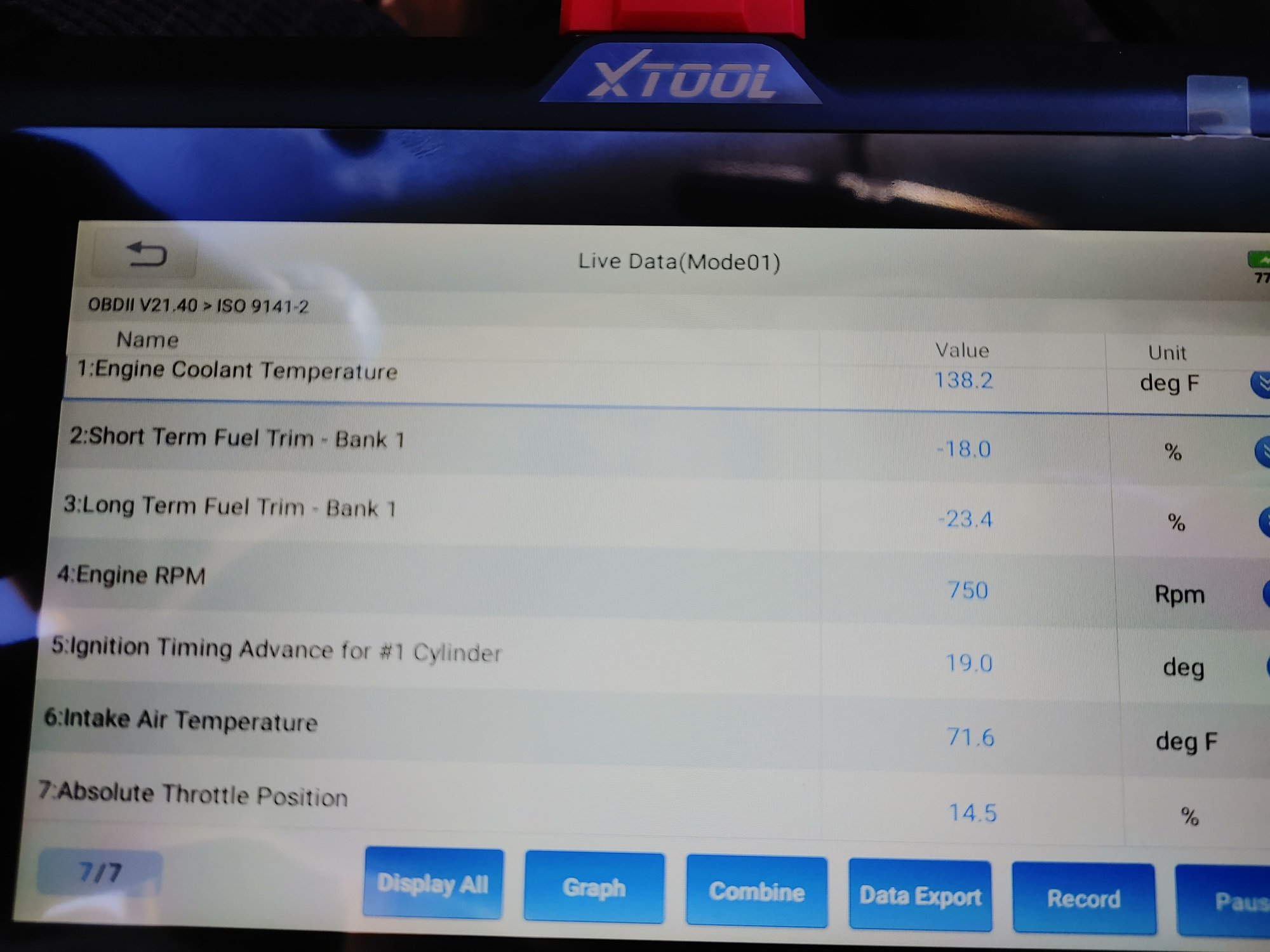

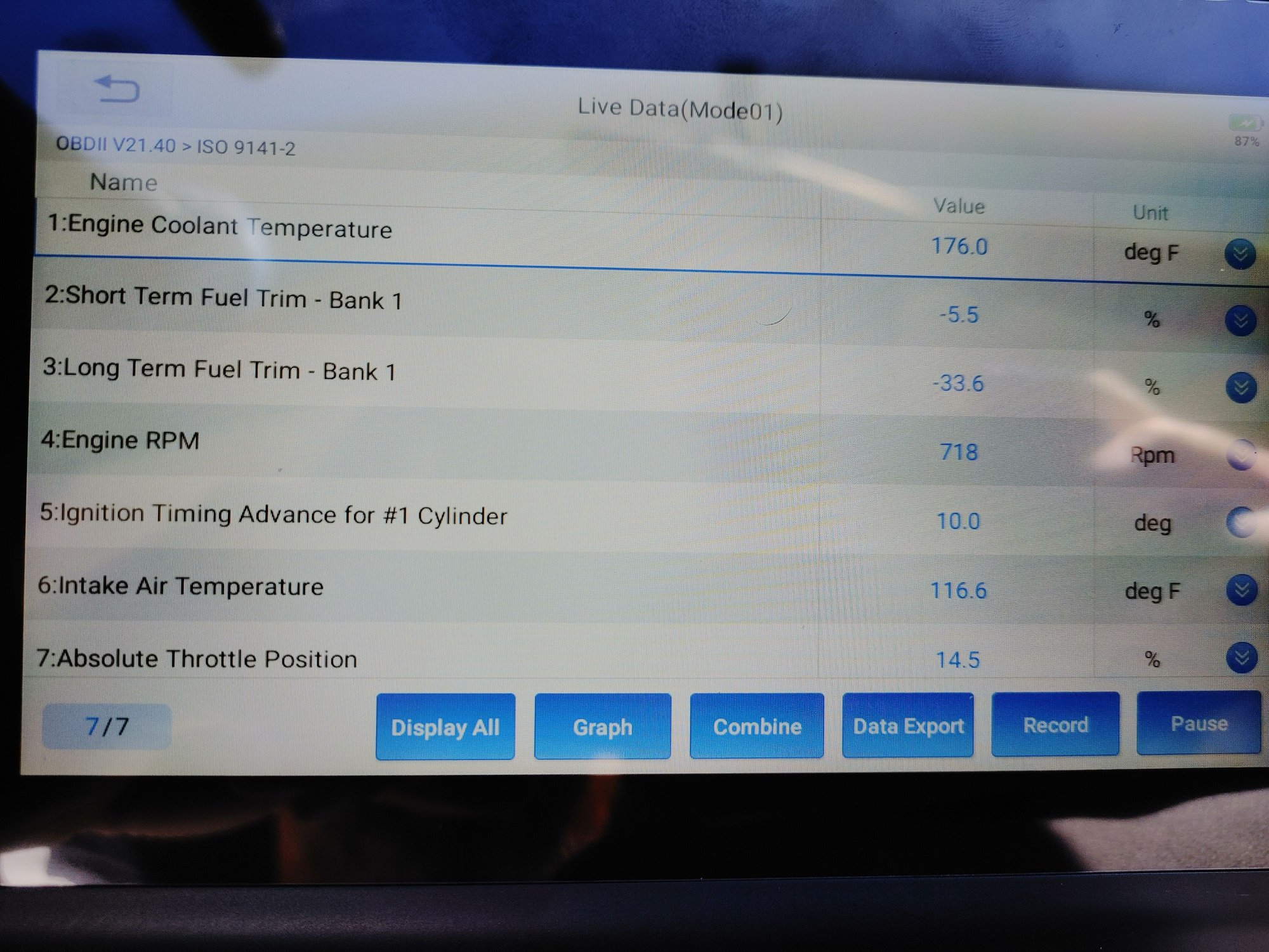

I replaced my oem with Chinese 232.1cc p/m 4pin nozzle, it has a rough idle @ cold start, but works better when warmed up. LTFT shows -23-39% which shows PCM trying to lower the fuel, because it running rich. Would the truck benefit from a 4pin nozzle vs 1pin nozzle if i spend more on oem bosch 4pin nozzle vs oem 22.1lb p/h vs stock 23.2lb p/h injectors.
OEM stock 243.8cc p/m 1 hole nozzle
Old Jan 14, 2024 | 08:59 AM
Posts: 87,475
The chinese replacements are a lower flow rate, but long term fuel trims are still -23 to -39??? Something ain't right there.....

LTFT was captured during the cold start open loop. after the truck got to normal operating temperature LTFT was -23% STFT was -6% closed loop, MIL or CEL came on with 02 B1S2 voltage High, probably it detecting rich condition. and pending codes were misfire cylinder 1 and 4, which i think its stuck spraying too much fuel because their cheap Chinese injectors 4pin nozzle, so I plan to replace with genuine bosch with same 232.1cc flow but 1pin nozzle 0280155934.

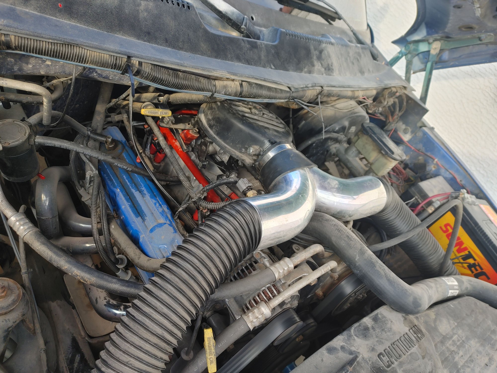

2. so far, have plume gasket has been fixed along with 52mm mod on the throttle body, electric fan set to 190 via radiator sensor and 180 thermostat, dual short ram intake with IAT sensor relocated to intake ram.
3. the MAP and idle air valve has been replaced, water pump and timing chain, starter replaced. both o2 sensors replaced along with hi flow fat, and shorty headers.
Truck has rough idle on cold starts starts good then start to boug down to the point it wants to shut off. I usually then it off and restart it again then it idles better, almost seems its need getting good spray of fuel on cold start..

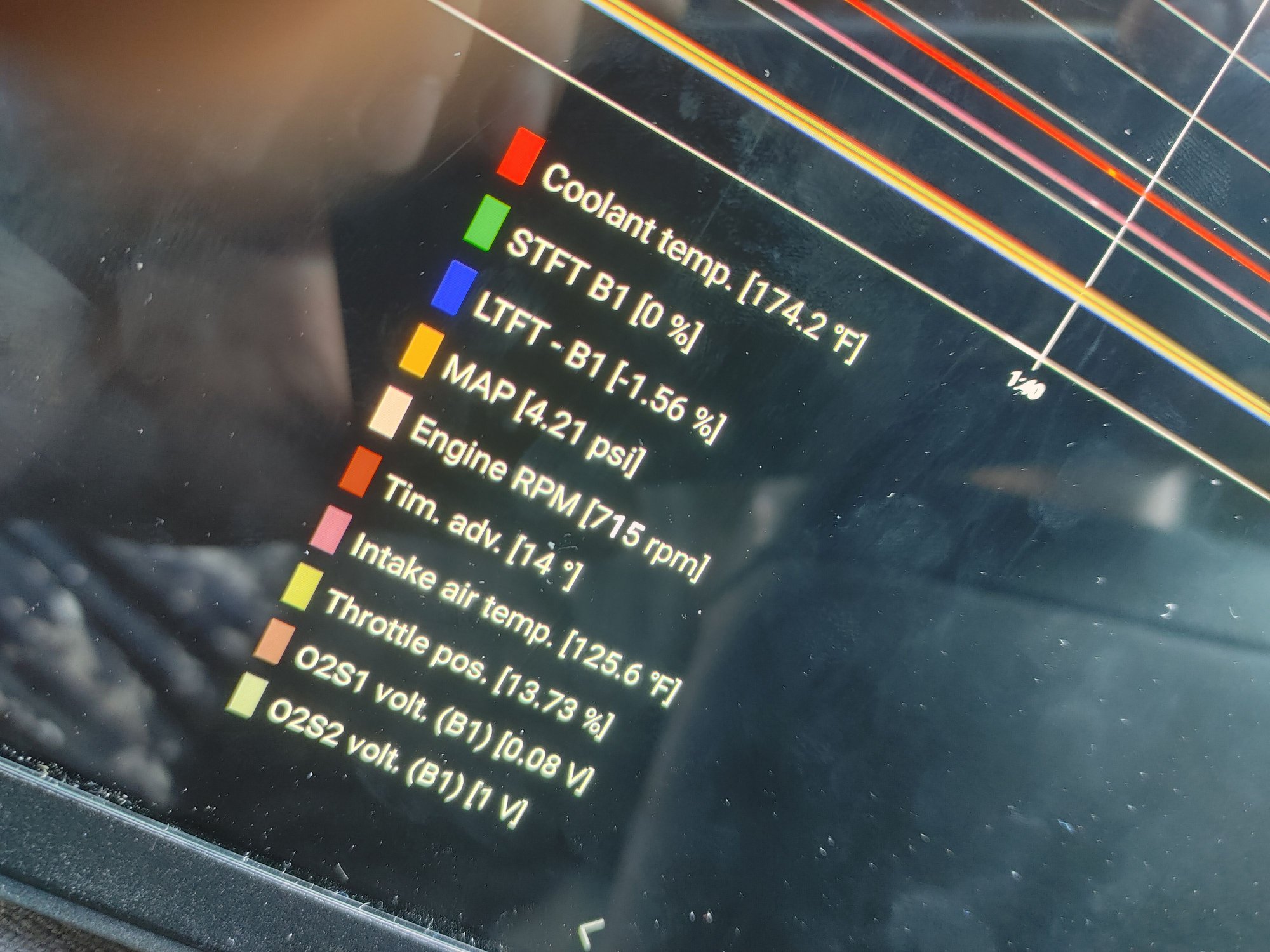

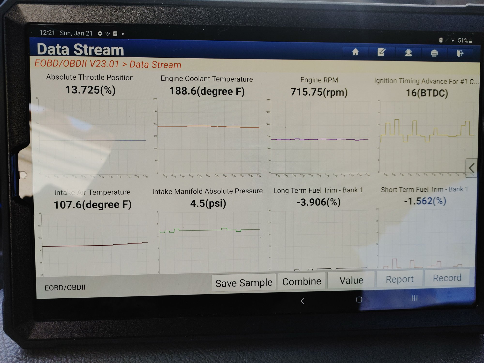

after 2 hrs i got the truck running alot better, the new injectors seems to be working better but im still getting pending codes p1038 b1s2 hi volt and misfire cylinder 1. here are some pictures. I no longer have the xtools d7s didnt like the battery life, so im only been using my tablet and my clone elm 327 bluetooth dongle and diagzone and torque app and car scanner obd2 app.
Old Jan 21, 2024 | 07:21 PM
Posts: 87,475
Fuel trims look good. How is your cat? Is it still there? Does sensor 2 stay pegged at 1 volt??

Posts: 12
now that you mentioned it, b1s2 does seem to hang @ 1v even in CL so I'll have to look into that closer, when the weather is nice, b1s2 is only year old but it might been caked with carbon from the other Chinese injectors that seem to have been getting stuck open, I do have a hi flow cat installed.
Old Jan 21, 2024 | 08:01 PM
Posts: 87,475
What brand is it? It may have simply failed..... Cleaning it is worth a shot though.
