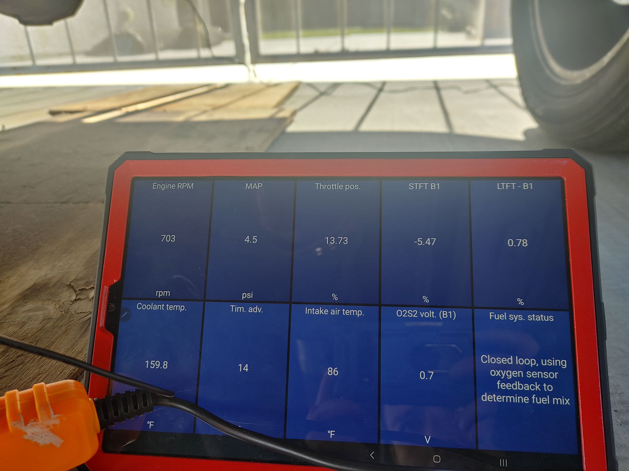

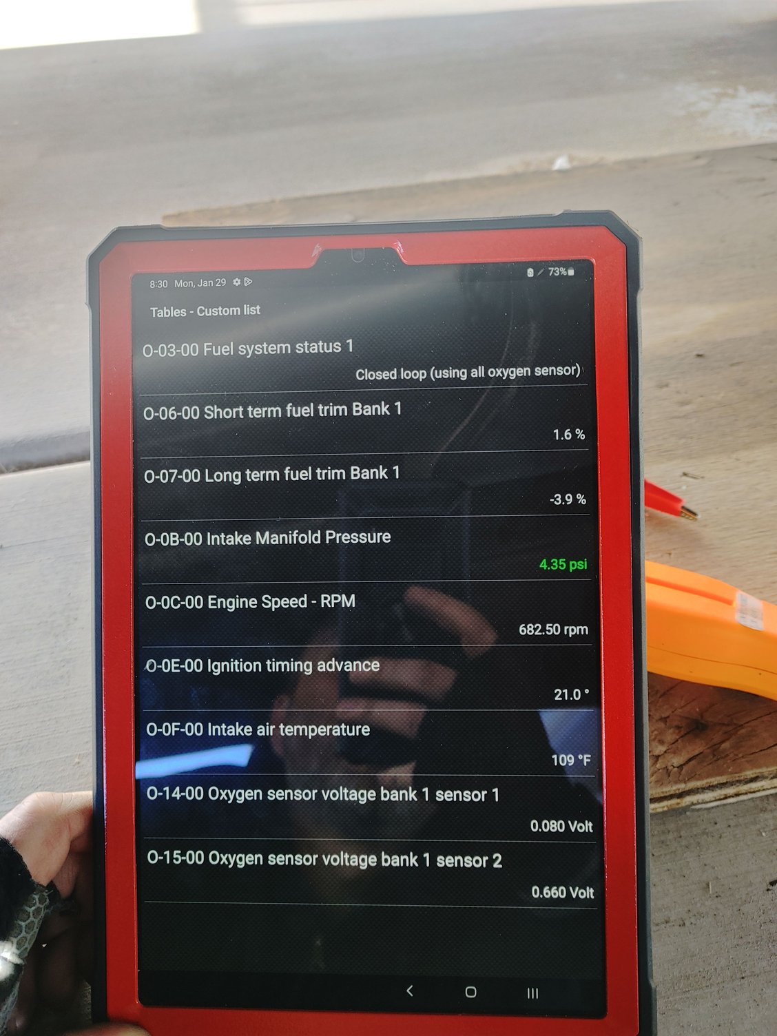

UPDATE i used a volt meter and i got 13v for the elements side and 4v from the signal wire on the truck side of connector . and today i used my power probe and i got ground on 3 wires with key on and 13v with engine running. the only wire i did not get a reading from either off or running was orange w/black it was neither hot or ground that same wire on the sensor side is black wire. And today it decided to work for not reason nothing had changed the only thing i did before taking measurements was i swapped my ASD relay for another one and that's all and it seemed to get working as it should. I do not know if that ASD relay had anything to do with it working again, i did try to look for a break in the wire on the truck side connector b1s2 but i couldnt find one
Old Jan 29, 2024 | 03:37 PM
Posts: 87,550
Likes: 4,230
In the third shot there, sensor 2 is showing .16 volts.... in every other shot, it is .6 or higher... is the voltage switching at all?? Or does it just remain steady? I also not, in shot 3, the engine is up to operating temp.... In the first two, it ain't quite there yet....
