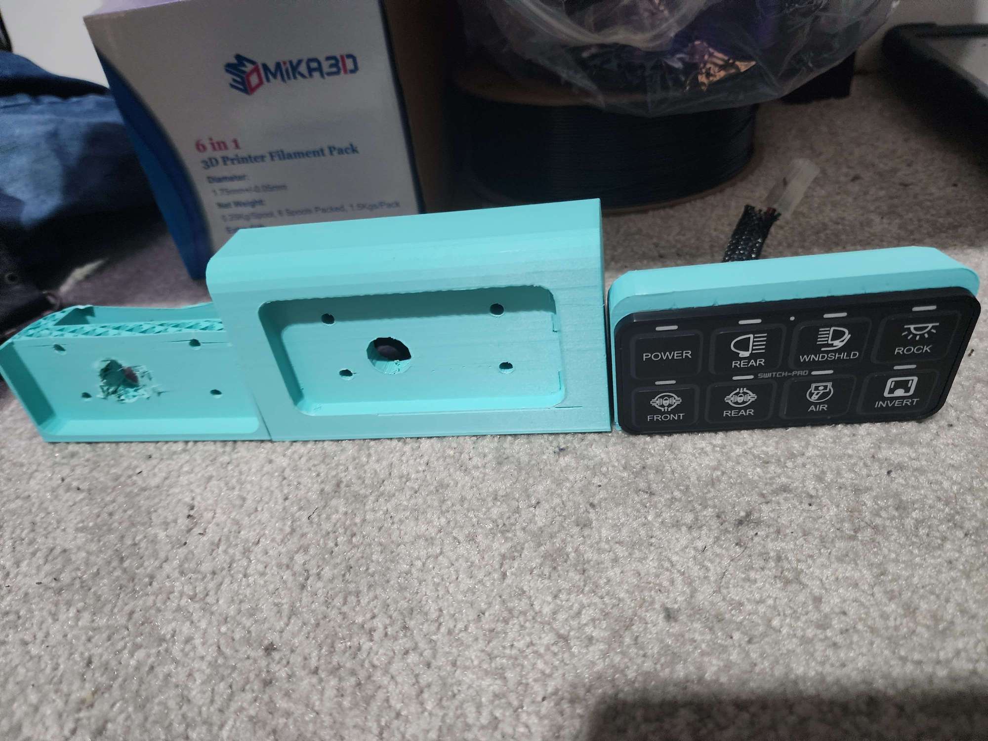

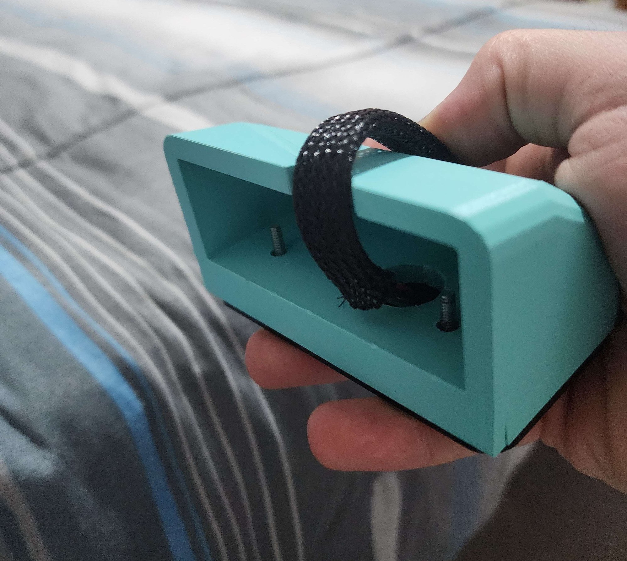

I run two Switch Pros SP9100 Switch panels in my truck to control my On Board Air, Off Road lights, etc. Nobody makes a mount for the second gens so I designed and 3D printed one. In the photos with the 3 different mounts going left to write are my renditions. 1st printer messed up, 2nd was to big, 3rd is just right on my opinion. Will redesign it once my 3d scanner comes and I scan the dash to have the right curvature. I made it rolled to kind of match the dash. It will be reprinted in Agate ABS one I scan the dash. I left the bottom open to get to the nuts and even cut out a half circle for the harness to pass through. I'll use either double sided tape or velcro to attach it to the dash. Any opinions are welcome!
