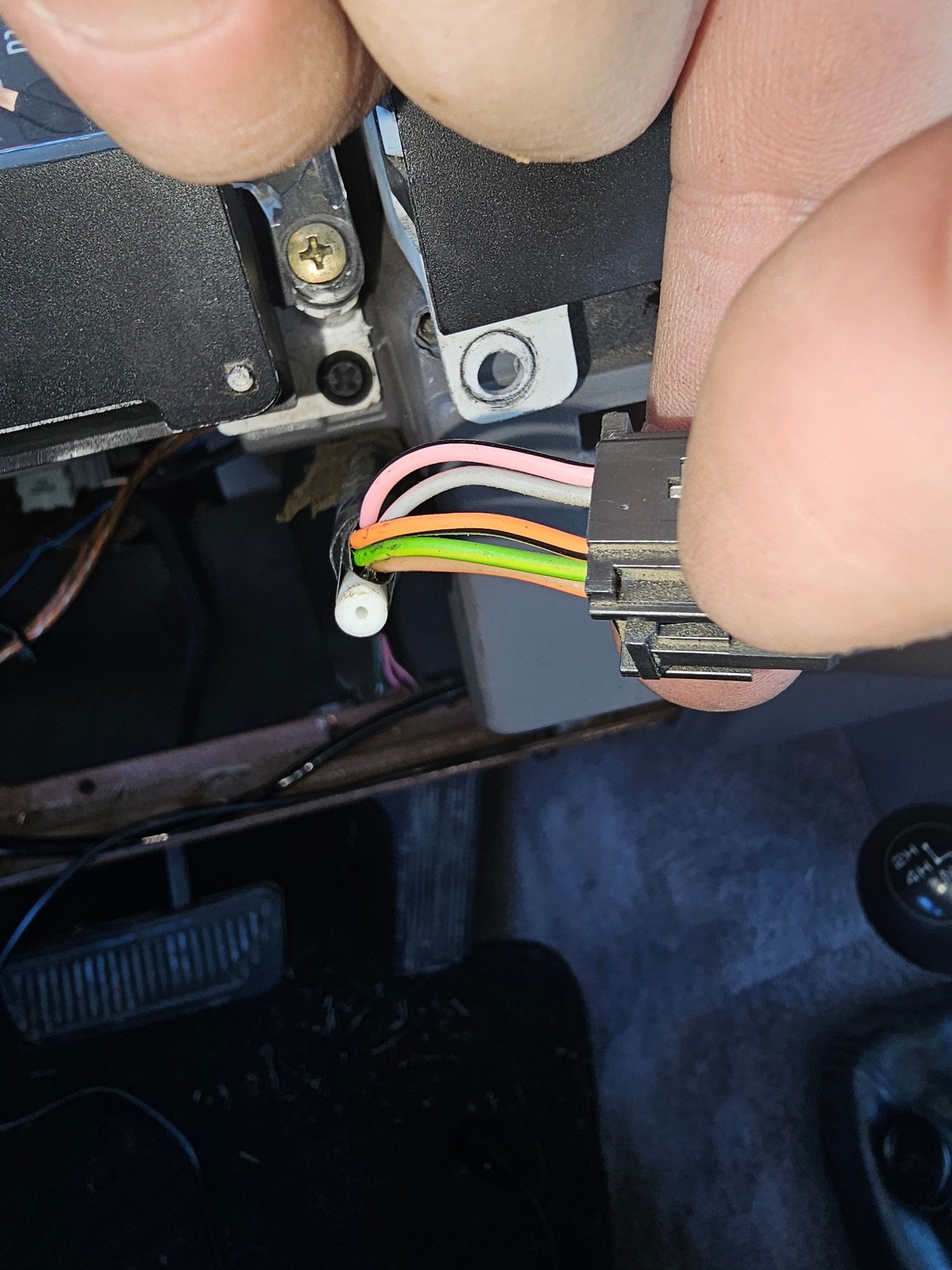

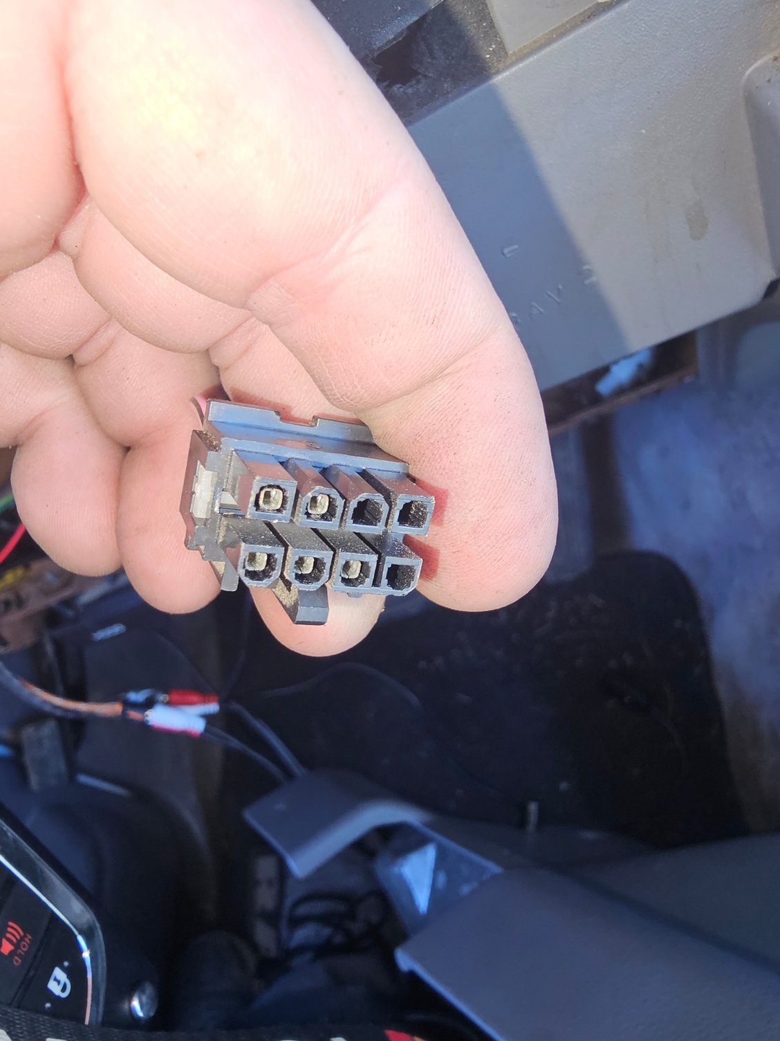

The only plug i found under the dash
Only the green with yellow stripe has switchable power checked it wit a test light

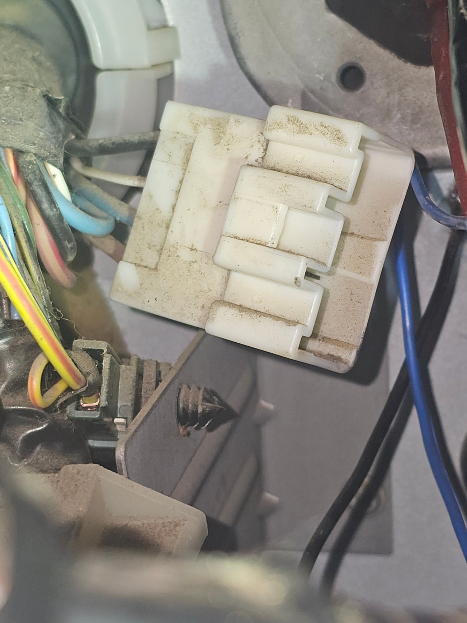

Found this flat plug it comes thru the firewall dont know wat it is

Ya im lookin dash is apart but cant really pull the cluster its so tight still lookin for it i did find a couple plugs therr also in this post wat i found

I believe that big white connector is for connecting a brake controller for towing.

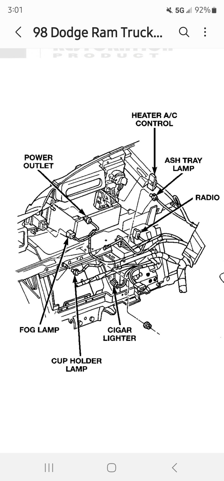

That manual doesnt have factory fog lights or even the switch setup like if i download the 98 one it says foglights be connected to 12 power
The 96 one doesnt show foglight wires but the 98 one here says its by power outlet
Old Mar 15, 2024 | 06:55 PM
Posts: 87,475
Things changed a couple times in 98..... Don't go by that one.
The foglight stuff is in the Front Lighting section.... I found it without too much trouble.
