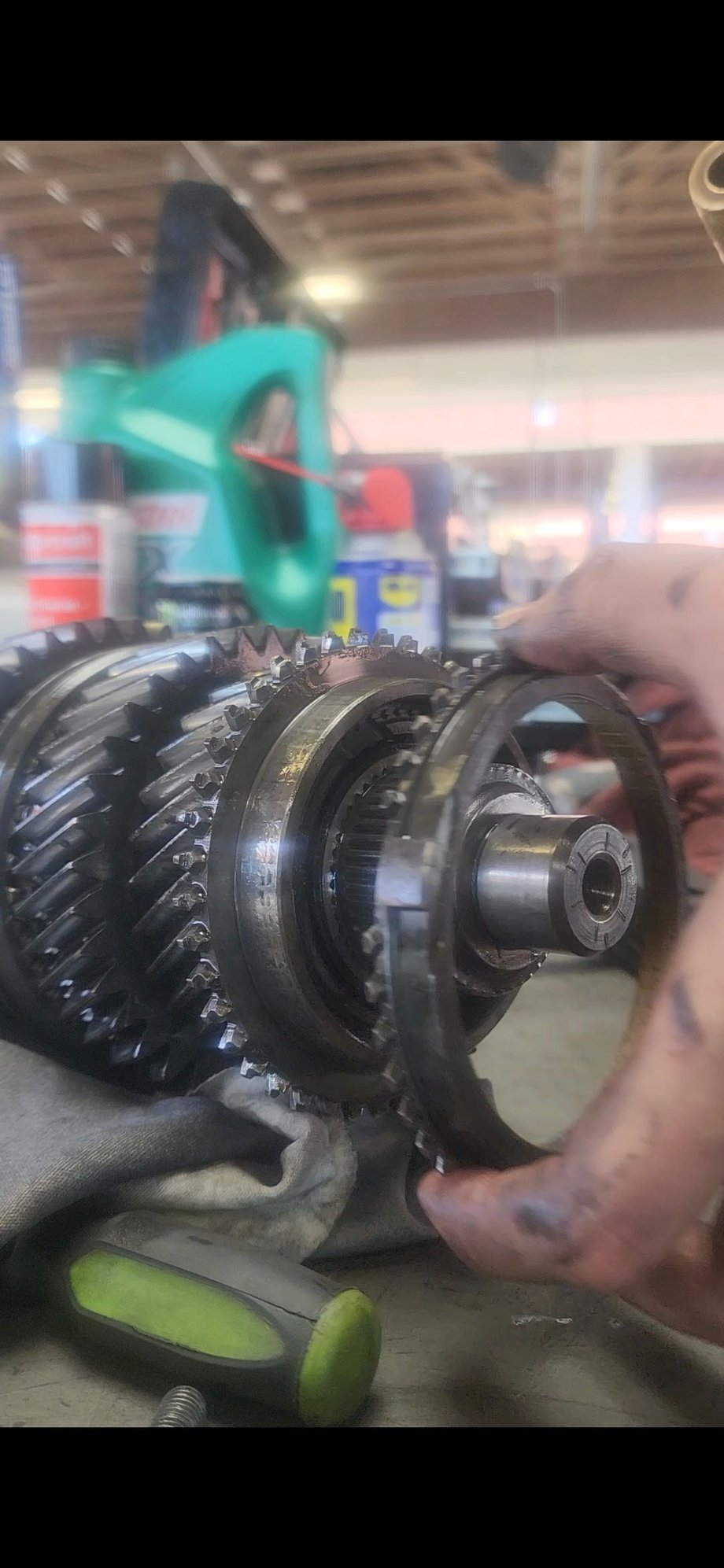

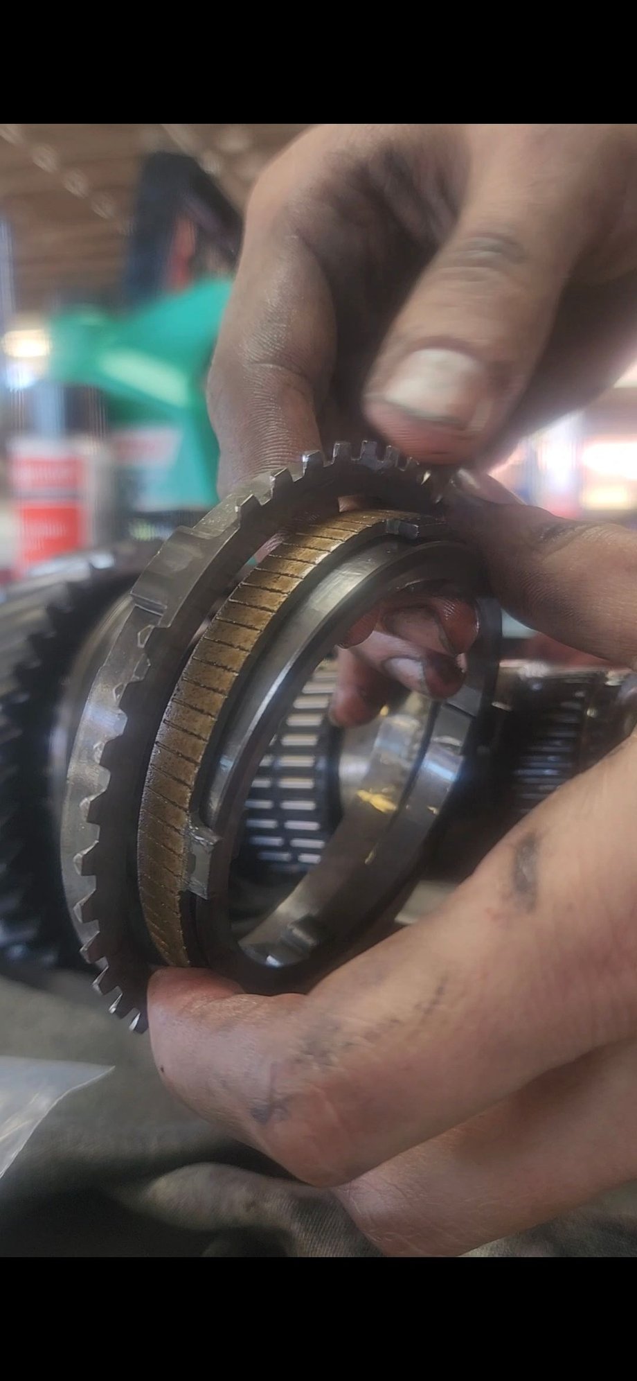

Hello,
Just to make sure we're talking about the same thing, I've attached some pictures of the original 3 piece synchros that come on 1st and 2nd gears. As well as the 1 piece synchro found on all other gears. Are these the same synchros you pulled out of your transmission?
If you could attach a picture of the synchros you purchased it would be helpful, but I'm assuming they're the one piece synchros for 1st and 2nd which are not interchangeable with the multipiece design. Not sure which design came first but they don't mix. Don't press anything. This all fits together by hand. I realize I'm a bit late to the party but I hope this helps.
