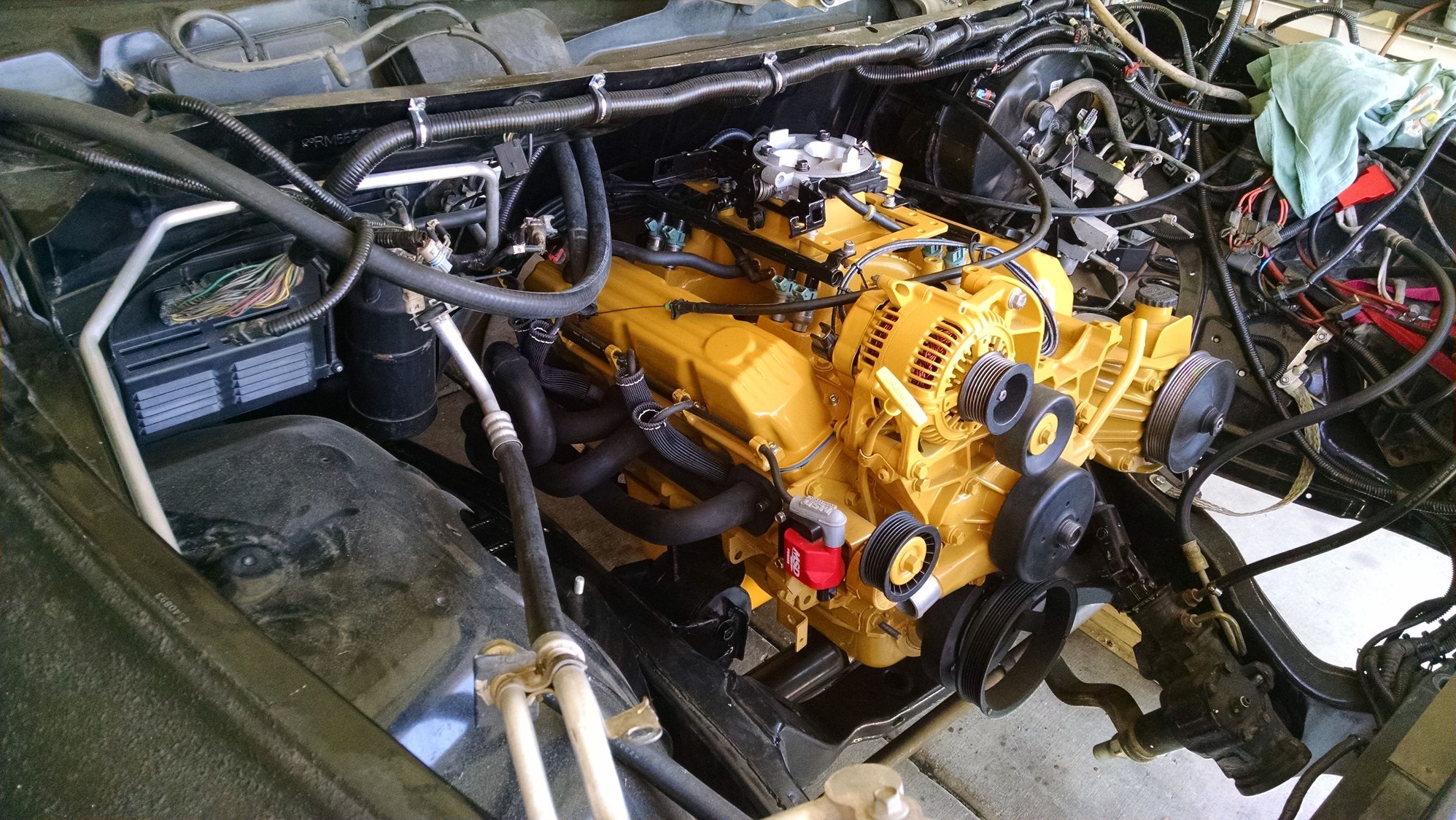

"mildly build up" - Engine bored out 0.030", Odessa New Cylinder Heads, Hughes Air Gap Intake, 52mm Throttle body, 24lbs injectors, Hughes HER0814AL Camshaft, Hughes HUG 1550 roller rockers, Gibson Headers, Recent distributor cap and rotor, Hemifever tune installed.
I have to double check on the engine light flashing.
Here is a pict of when the engine got installed - I painted it Caterpillar Yellow
Picture still has OBDI ECU - it was changed since then.
