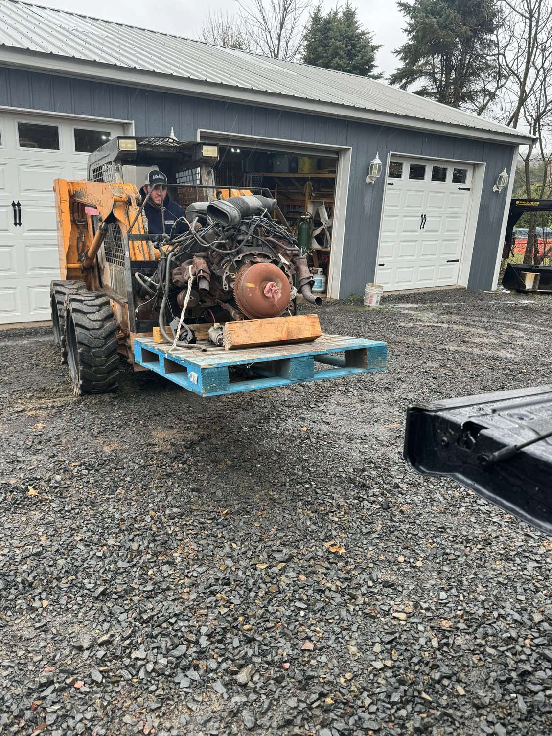

I already have the motor. Bought it used running from a 96 out in PA lol. It was in the truck and he has it running than pulled it for me.
