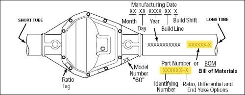

This is what i got out of the Dana manual.
44
620216 Seal – Tube (left side)
43154 Seal – Tube (right side)
60
— (2) Seal – Tube (left side)
— (2) Seal – Tube (right side)
(2) See "Variable Parts Table" within this section
You need the BOM# to look them up for the 60. Chrysler did not make the axles Dana did. I would look it up using the BOM# then get the part # both from Dana and Chrysler, Should be the same part with a different #.

Anybody have teh front seal part numbers?
Read post #6, Need the BOM # to look it up! Both pinion and hub seals need the BOM #.
