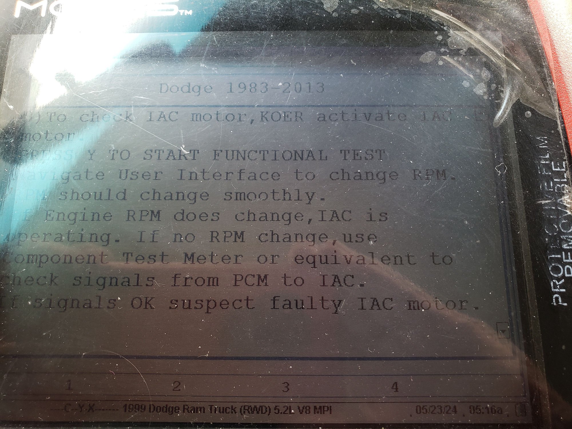

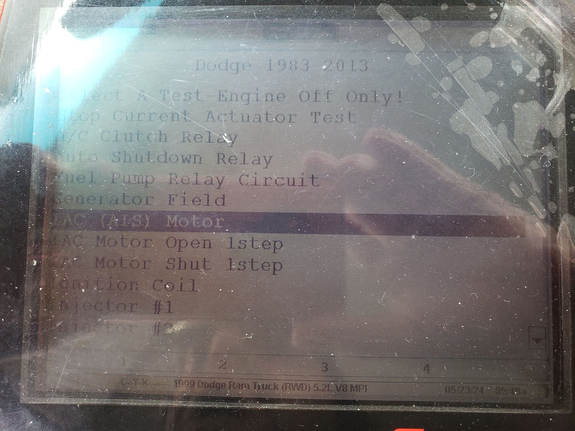

aren't helping much with just a voltmeter and no scan tool.
If his 1999 5.2 Ram has a MAF that's the first I've heard, they use speed density to calculate incoming air: RPM, MAP, and internal memory table.
If you mean MAP, a scantool should show it at atmospheric pressure engine off (29.92Hg) and 12-18 at idle. Yes to clogged MAP will stall the engine.
IAC can be tested by going to IAC test and adjusting idle RPM, if RPM doesn't change the IAC is stuck.
Unlike IAC on other vehicles, it doesn't have a sensor to detect pintle position so won't throw a code if it won't move to the position the PCM commands it. The Ram's IAC code is a basic driver circuit test to see if there are shorts.
I have a Snap On Solus Ultra I just didnt have it on me at the time. Dont gotta be cocky.
