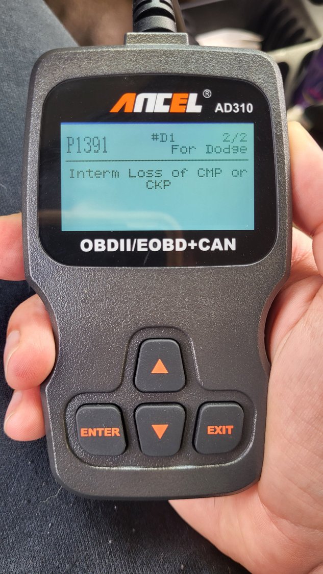

I attempted to do this, when I first started up the truck I was able to read the information, revved the engine to 2000rpms and didn't have an issue, floored the petal and got it to misfire and code reader couldn't continue to read the PCM live data, but I did get a new code. P1391. I plan on replacing the camshaft position sensor.
(I've replaced this twice already..) I'll be buying a genuine one from Mopar. Mopar 56027870 Crankshaft Position Sensor.

Once the engine is running, the PCM ignores the cam sensor. Replace the crank sensor. Use ONLY a genuine mopar sensor. Yeah, I know, they ain't cheap.

I believe that's the same code I got when my truck died on the side of the road a while ago. I rest the PCM after the truck died and limped it home. I ended up replacing the crank sensor with a Mopar crank sensor (to replace the BWD sensor that I got about 3 - 5 years out of) and all has been great since.

Alrighty, the crankshaft position sensor fixed my issue of it backfiring. New problem now is that the engine is dying when I'm coming to a stop and I'm dumbfounded on what to do next.
