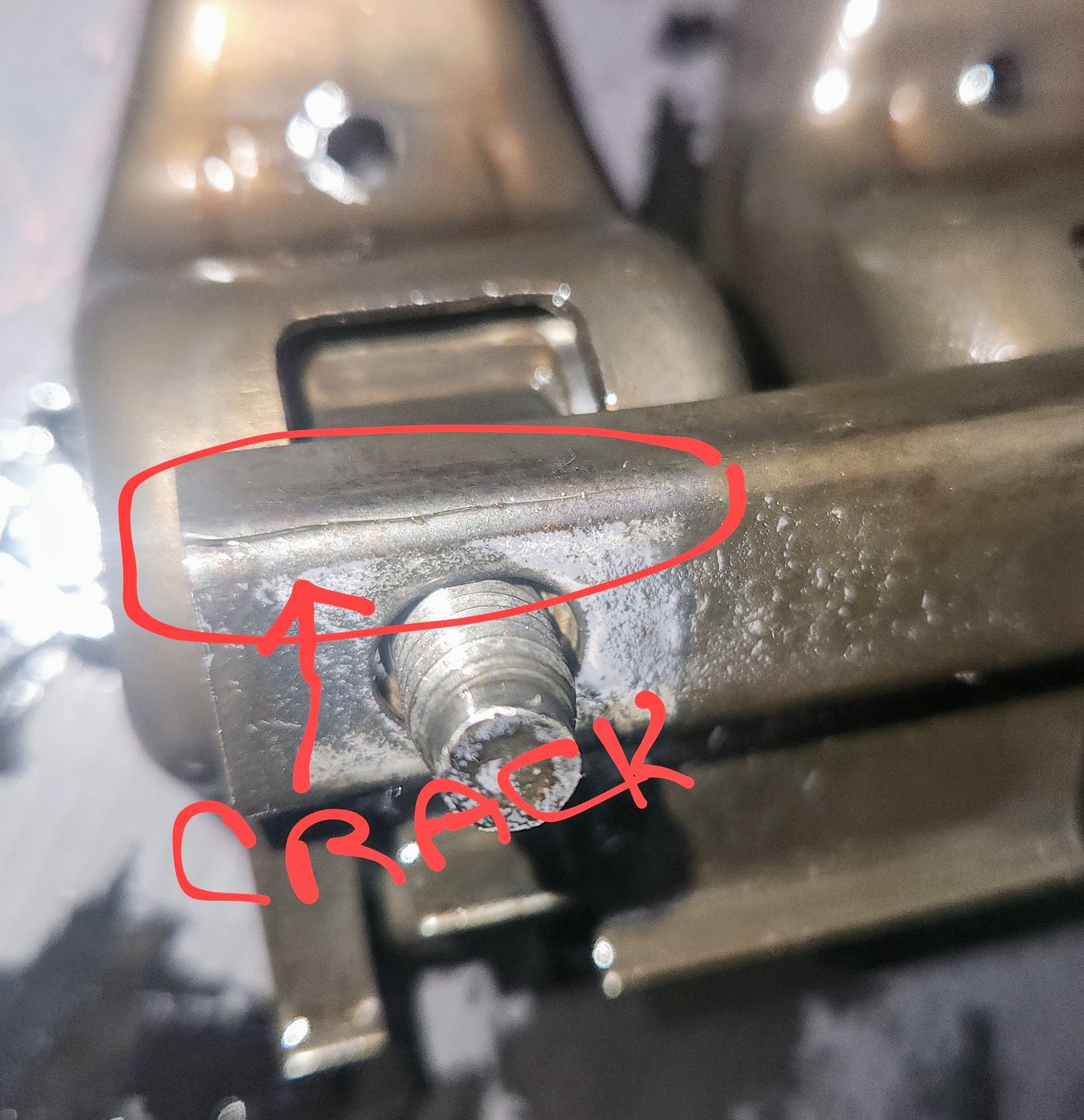

Turned out the "Rocker Arm Pivot Retainer" or "Tappet Retainer" was CRACKED which allowed the pivot to come UN-seated. And, with THAT we have finally come to the bottom of the rabbit hole! Just in case anyone else ever needs this part, it's Mopar Part #53008633. BUT... IT'S A DISCONTINUED PART. Even the dealership couldn't find it nationwide! So, you'll have to find a salvage yard that will let you pull parts from an engine. Or try Ebay. Hope this helps someone else. 😎
