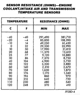

Check the resistance across the pins of the ECT sensor, it should be ballpark in this table:
99 should be a 24V with an ECM so check resistance across pins 14 and 11 at the ECM if the above checks out.
everything on the sensor seems to add up and I checked the resistance which I believe is good at 2.36 when truck is cold
