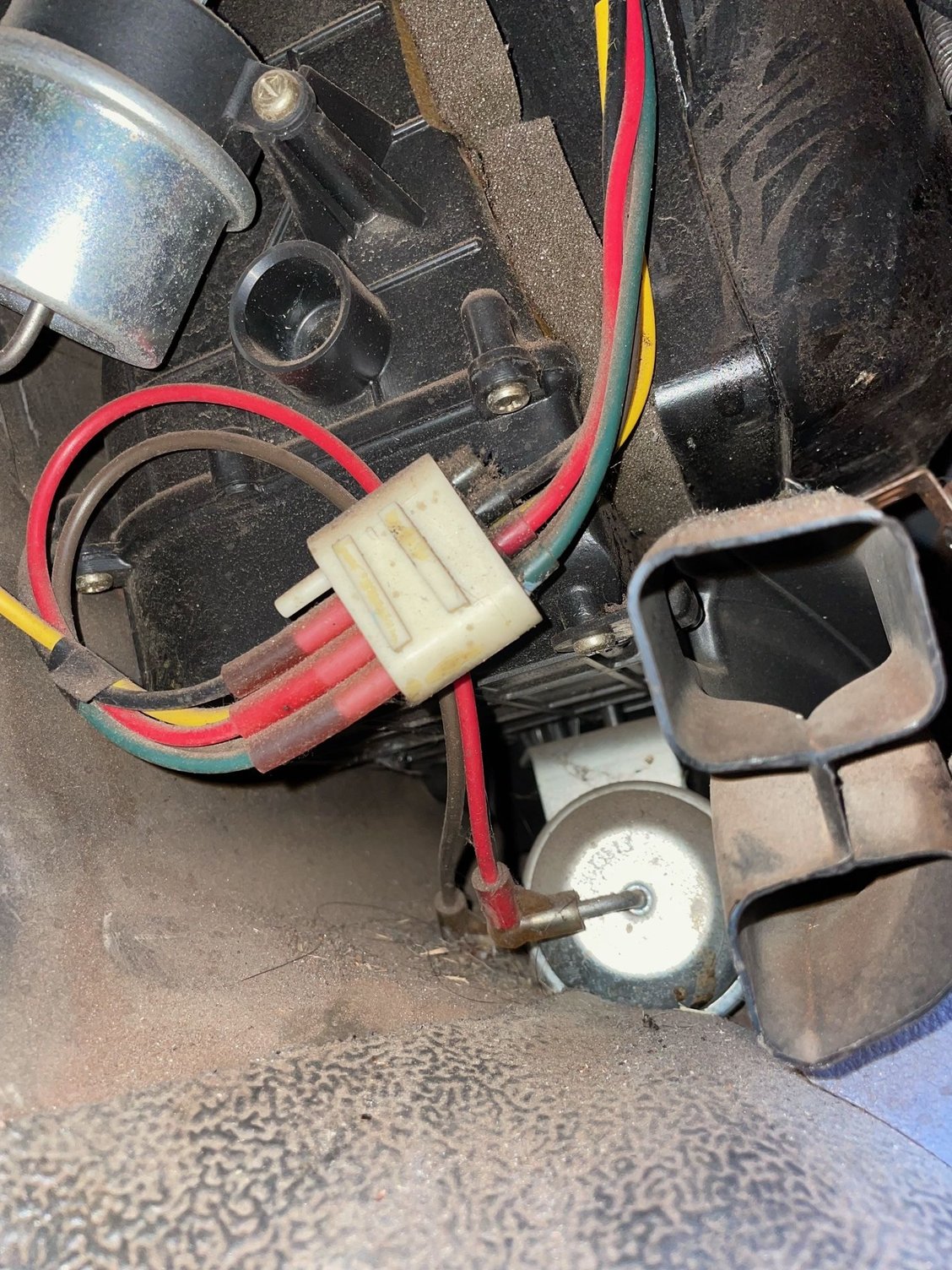

Oct 16, 2024 | 12:49 PM
I just looked under the dash and saw this. Which line should i check and should something be connected to that one open nozzle?
Reply 0
Oct 16, 2024 | 03:24 PM
What motor is in your truck?
