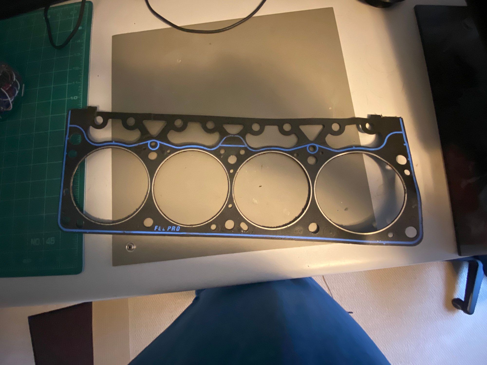

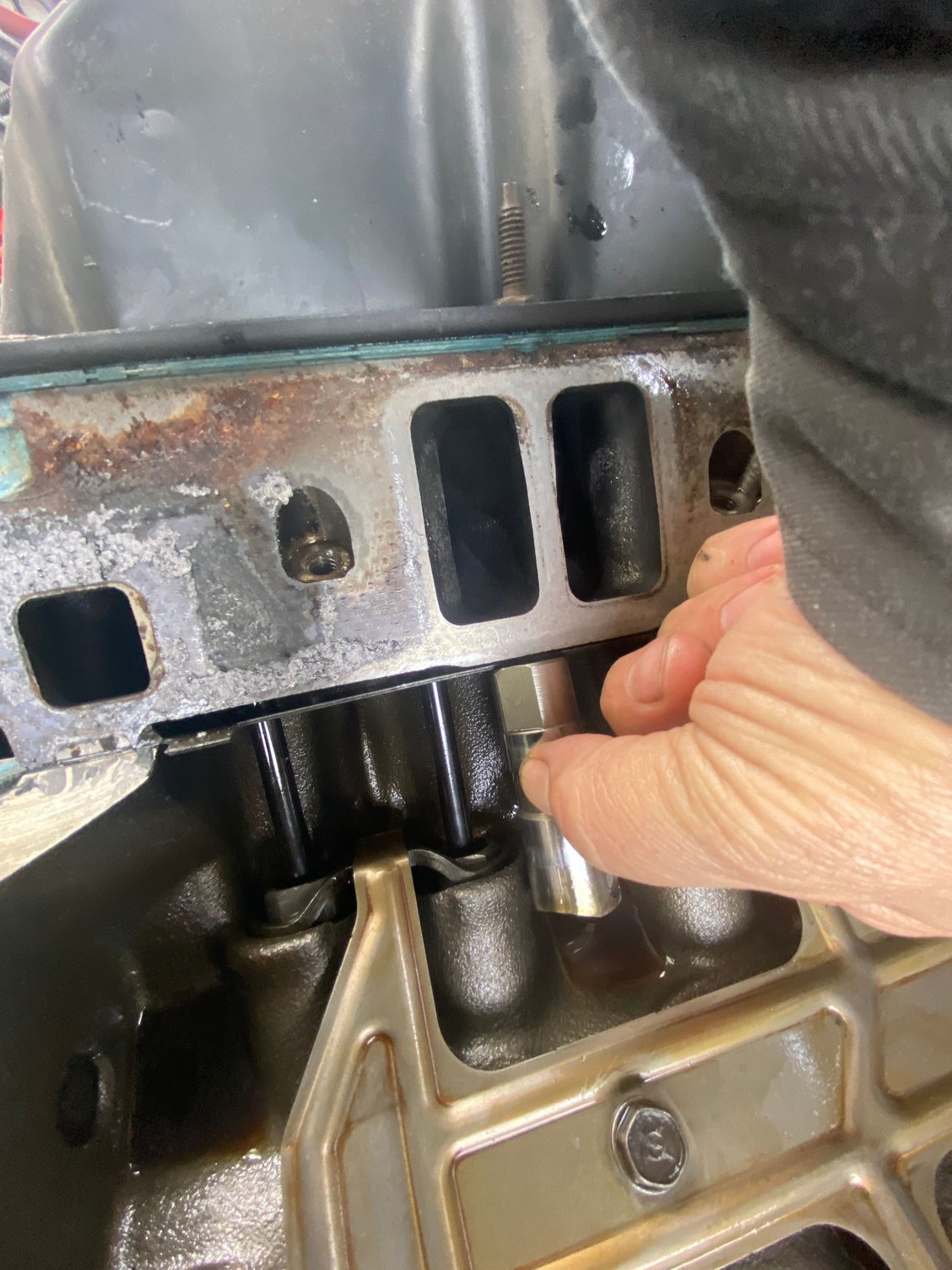

I bit late here but I wanted to correct myself on this one.. Depending on the head gasket you use, you MAY have to pull the head to replace a lifter(s). This also means dropping the exhaust y pipe and pulling exhaust manifold off as well (or perhaps pulling if together with the head as a single unit but that is a bit of a nut-buster to lift yourself).
Well, I just went through this process to replace a couple of lifters the other day. I have used the FEL-PRO #9898PT on the last couple of Magnum V8 builds and the problem is the gasket extends out beyond the block to where the pushrods are mounted and provides a set of "guide holes". These interfere if you try to pull the lifters out of their bore with the head gasket still in place. See attached pics... I suppose you might cut away this part of the gasket around the guide holes because I'm not certain it provides any structural support to the gasket itself sandwiched between the block and the head but be aware it is tough material. I tried to cut it with side cutters (after removal) and it is tough stuff.
