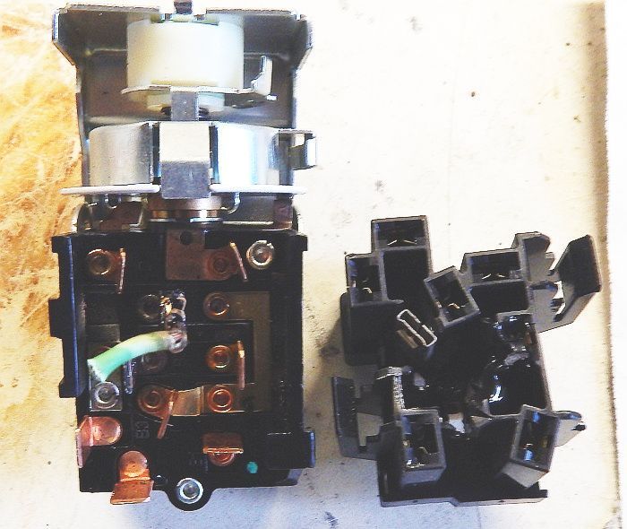

You have a 2500 so you have more lights to power than a 1500. There was a recall on the 3500's for burning the switch and plug. This should have also covered the 2500. I replaced my switch and plug at lease 3 times. Put leds in the markers/etc this will help bring the amp draw down. One thing i notice is they get the "sport" headlights wrong. I'm looking for clear lens housings for hid retrofit. As mentioned the quad lights didn't start till 98 and they confuse the earlier versions of the sport with it. Start at your switch and plug then the wiring. This is what my first one looked like.
