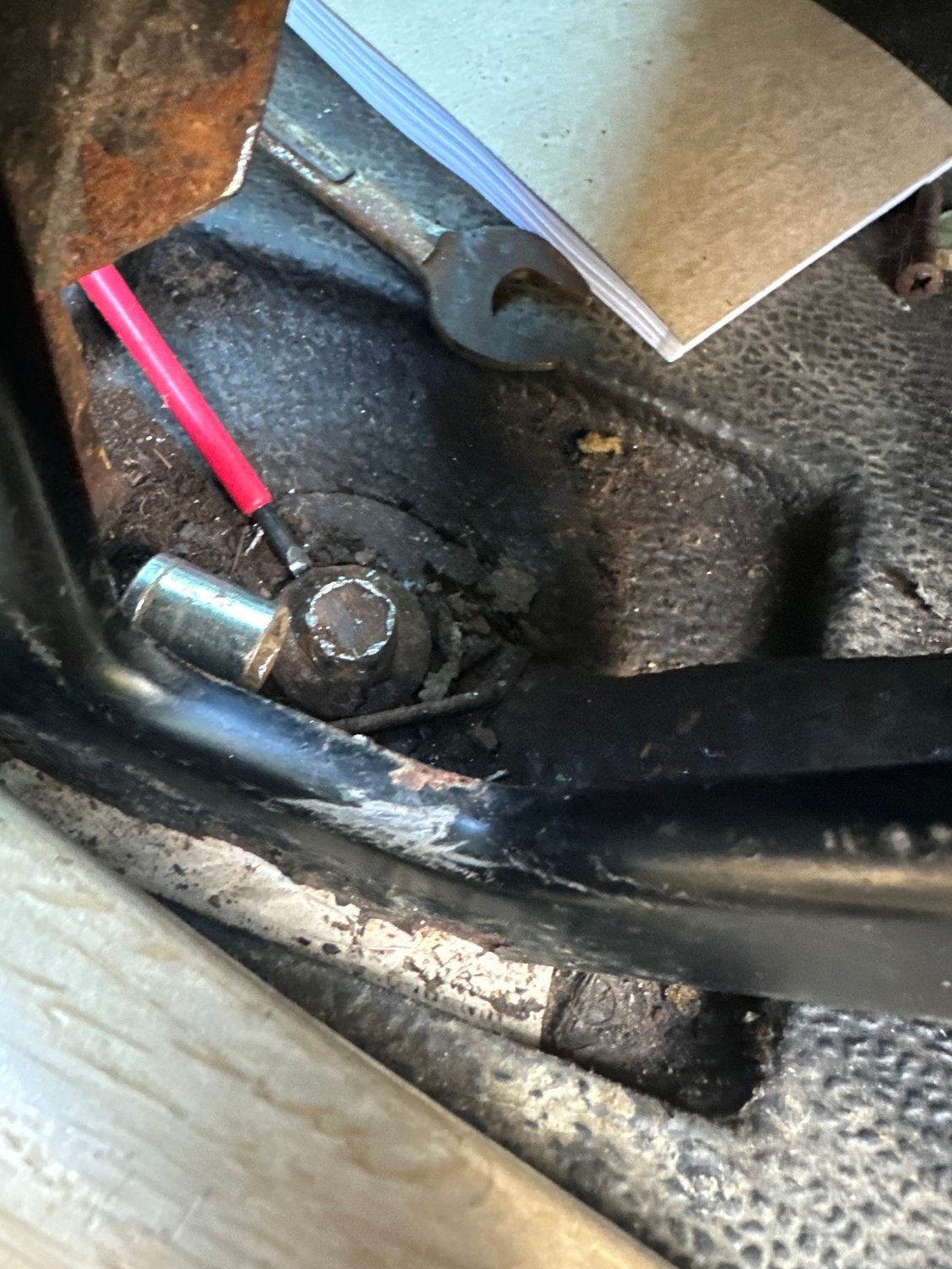

I have a set of 60-40-60 seats i just recently purchased. My original bench seat front mounting bolts are completely seized, rusted, and free spinning along with the cab floors surrounding them being very brittle and some small holes. Can i remove the cushion from the bench seat and mount the 60-40-60 seats on the original black seat mounts? or will i have to look for another option.

Need to fix the existing bolts. In the event of an accident, you don't want your seat ripping loose. You really wouldn't care for that particular ride. Chemicals are your friend here. PB Blaster is my personal favorite. Clean up the part of the bolt sticking out you can see, and hit it with chems, be generous.... once you have the bolts/seats out, fix the floor. (weld in new metal if you have to....)

Chemicals and mostly lots of heat will help to remove the seat bolts. I've had to remove seats out of 2nd gen Ram trucks a couple of times and always encounter at least one seat track bolt being stubborn/hard to remove. On my own truck, the driver's side front seat bolt head was terribly rounded and almost rusted away. I had a friend get under the truck to put a massive amount of heat on the bolt from an acetylene torch until it turned cherry red, while I used an air hammer and chisel (plus some candle wax on the bolt threads after heating the bolt) inside the truck to knock on the bolt head enough to get it to start turning. Once the bolt started moving, I used a pair of Knipex pliers to continue turning and finally removing the seat bolt.

Not everybody has acetylene at home and are stuck using propane. Even then a lot of times it won't be enough. Clean the rust off the bottom of the bolt threads, If it does come loose the rusted threads won't get stuck. Most times the bolt breaks before you can get it out. The head of that bolt is chewed up so just cut it off with die grinder/grinder with a cutting wheel. Wet the surrounding area so nothing catches fire and watch where the sparks go! Having a spray bottle filled with water is also a good idea. After you get the seat out have to look into repairing the rusted floor.

Gotta be careful with heat. Carpet padding, and the carpet itself are in direct contact with the floor there..... Don' wanna burn the truck down.

MAPP gas is a hotter, affordable and readily available alternative to propane..

What scares me is looking at the rusted and cracked floor pan. The bolts are a pita sure .... am not allowed to play with fire ... I probably would use a zip disk and a grinder to remove the bolts.
Then the job is to weld in and patch the floors to get some strength into it ... does not need to look pretty, just strong.
Why worry about replacing the bolts when there is nothing to bolt to?
Maybe even some self tappers and some 16 gauge metal if there is no welder available .... just something anyways. No it would not be safe, at least your guardian angel knew you tried.
