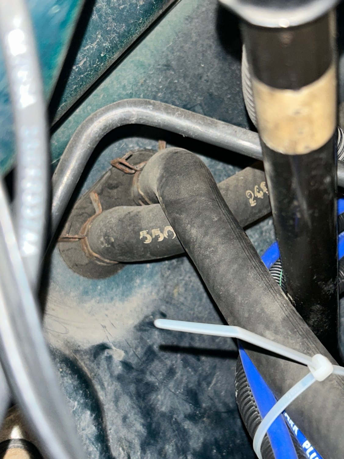

Originally Posted by stewartwp05
1999 Dodge Ram 1500 5.9 magnum. I know there are plenty of threads on the heat not working in these 2nd gen rams, though while trying to figure out why it’s not working I saw this:
I can’t find a very good diagram of the heater core lines, though these look backwards, and if they are backwards what would be the point of doing that, also could that be the cause of having absolutely no heat? I just got the truck about 3 weeks ago and am trying to get the heat fixed asap, this Ohio winter is sucking with no heat so far lol. It blows cold out of all vents the vent selector works, I can hear the blend door moving when having somebody change the temperature quickly (I’m not sure if I’m just hearing the actuator move or if the blend door is actually moving), after a 10 minute drive both heater core lines are about 142 degrees. Any ideas or thoughts about why the lines would be switched would be awesome thanks!
Those are swapped from the way mine are on my '96. I'm thinking you might have a failed thermostat or one that somebody believed the internet and put a cooler thermostat in the engine. On carbureted engines, that will give you a denser charge, but on computer controlled it just wastes fuel and you don't get any heat. Put a good, 195 degree thermostat in your engine. Do NOT use a Failsafe unit. Everyone of those I've dealt with was either failed or it failed soon after.
Now, this will seem silly, but how many miles on the engine? If it has over 120,000 miles, your timing chain may have jumped time or has a lot of slop. I had a '94 once with the 3.9. The heat was warm, but not very. Fuel economy wasn't that great for a light economy truck. It had a lot of chain slap and I replaced the timing set. I also put a tensioner for later engines in it. The chain really woke the engine up. Afterward my fuel economy went WAY up (formerly 17 mpg later 24 mpg) and the heat would cook you. My '96 had 160,000 when I put a chain set in and it had slop but it wasn't jumped, yet.
