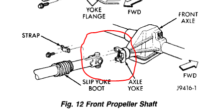

I recently lowered the FRONT PROPELLER SHAFT and changed 3 u-joints but one of the u-joints did not fit in the front yoke. Can you give me the measurements of the u-joint? I would need the measurements, much more than a part number

Can you tell us what u-joint you tried to fit? I'm wondering if you got one of the stupid Dodge crossover joints that use a half c-clip on the cap itself. Those are usually rear pinion only.
I thought the 3/4 tons were 1330 front u-joints, so a 1330 is 1.062" cap dia and 3.625" across the caps. It's symmetrical so this is true on both crosses.

I suppose it's the first one you said, do you know the measurement?
Only Dodges used it?
Will they be unique to this model?
They do not have a standard/universal numbering

That's most likely a 458 u-joint. I prefer the 458BF (Brute Force) to get non-greaseable. The dims and interchange numbers are here, HOWEVER note their "length axis 2" is from inner clip to inner clip, not cap to cap OAW
https://partshawk.com/moog-458-universal-joint.html?srsltid=AfmBOoobTE3zPT4hOZy--rpmy1-ZcwocigLjtIlrBJOD_l1GLXafQs1x
AFAIK only Dodge used these and they're stupid. Absolutely no reason for this design, and everyone knows those half-clips are weak (also true of D44 front axle joints).
I do, however, keep a couple 458BFs on the shelf because they're difficult to obtain on short notice. There's also a "baby" version of this dumb design I recently installed in a '93 B150 (van) with the 3.9
https://partshawk.com/moog-458-unive...OD_l1GLXafQs1x
I found this one on the internet ,what do you think about the measurements ? then I will go out to some local stores hopefully they have available.
TOYO brand G5-212X or 458C wheel bearing for Dodge RAM 1500 2500 3500/ Dakota and Durango from the 90's to the 2000's.
Measurements:
Slotted Dies: 28.6mm
Distance between Internal Retainers: 66mm
SMOOTH DIE: 27mm
Distance between external retainers: 92mm.
