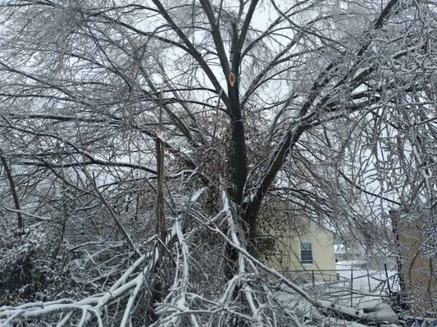

That looks familiar...... Gotta love ice storms....
At a previous residence, when we first moved in, the yard was a mess..... (several years of neglect...) I spent the entire summer getting it clean up, and mowed. Late winter/almost spring, we got two ice storms back to back. Half an inch of ice on everything, followed by high winds, gusting up to 60mph..... Come spring, you couldn't tell I had done a darn thing in the yard. FAR worse than it was when we moved in..... Guess what I spent the following summer doing.
