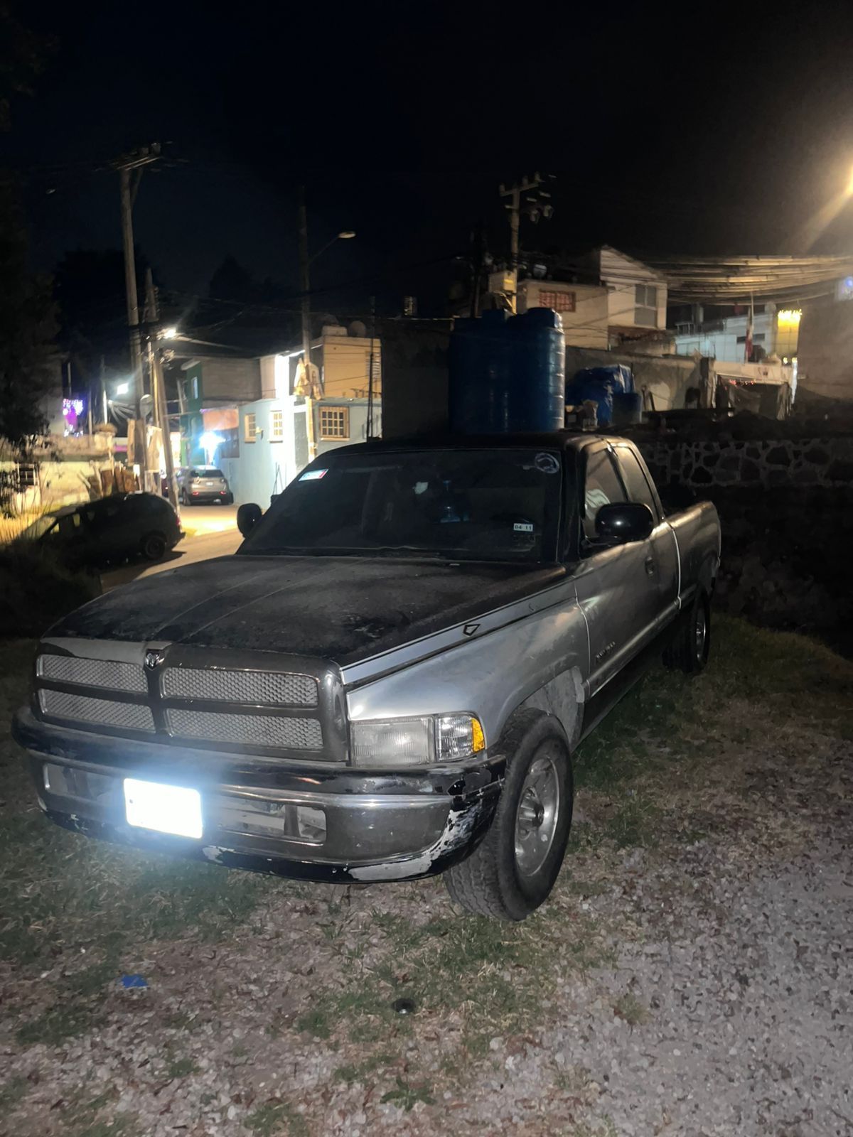

Hello everyone and sorry in advance for my poor english.
I am from the Rio Grande Valley. My dad, who lives in Mexico City just bought a 1998 RAM 1500 5.9L GAS and he is giving it to me. The odometer marks 269K miles but the truck runs smooth at least in short distances.
I was wondering if there is a recommendation on what to check, change or replace in order to make sure the truck makes the trip up north. The trip is 750 miles long and im planning in making it in two days.
