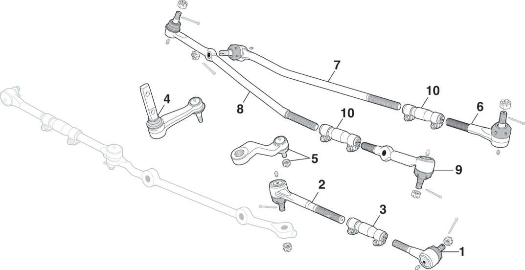

Are you talking about #6 in the diagram?
