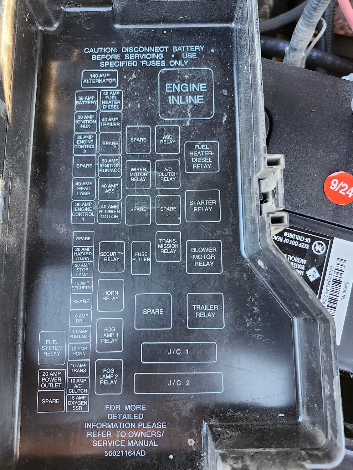

Hey everyone, I got a 1998 Ram 1500 with the 5.9 V8. Bought this truck last month and did all the maintenance on it just to know it's done. So it's got a brand new battery, good battery terminals, good wires ect. But it sit for a few weeks and drained the battery.
So I took the battery to get charged at a tire shop and when I put it in the truck again, it turned to ACC just fine and then started clicking. Now the truck is completely dead. No dome lights, no ACC, no cranking or noise. Nothing. As if it didnt even have an engine.
My only thoughts could be the 50A battery fuse or the 140A alternator fuse. I'm HOPING it's not the alternator for my own wallets sake.
What are your guys thoughts? Is there any other issues I should check that I'm not aware of? I didn't have time to check with my multimeter because I had to get to work but I plan to do that tomorrow
Edit: forgot to mention it wont jump either

Check in the PDC under the hood to see if any of the large fuses are blown. If so, replace the bad fuse and re-check to see if things are any better. If you have a pick and pay salvage yard near you, you can typically pickup those now expensive large fuses cheap or free. Also, check the battery cables to ensure you have a good battery connection at the battery and the grounds. You can also have a load test performed on the battery to ensure it's actually good. Even new batteries can be dead on arrival, due to a bad cell or two in it.
