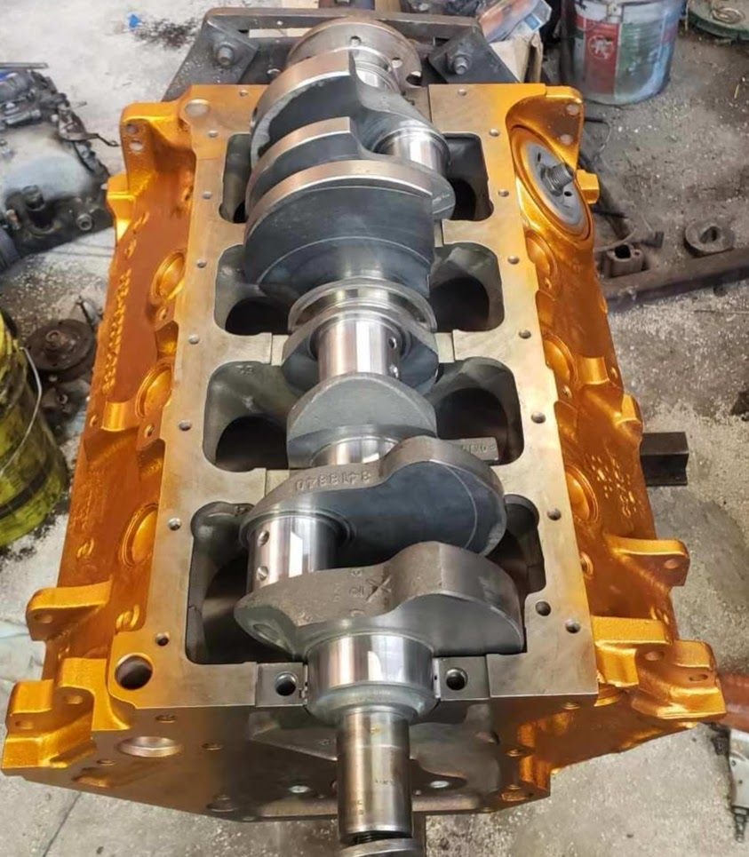

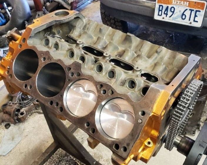

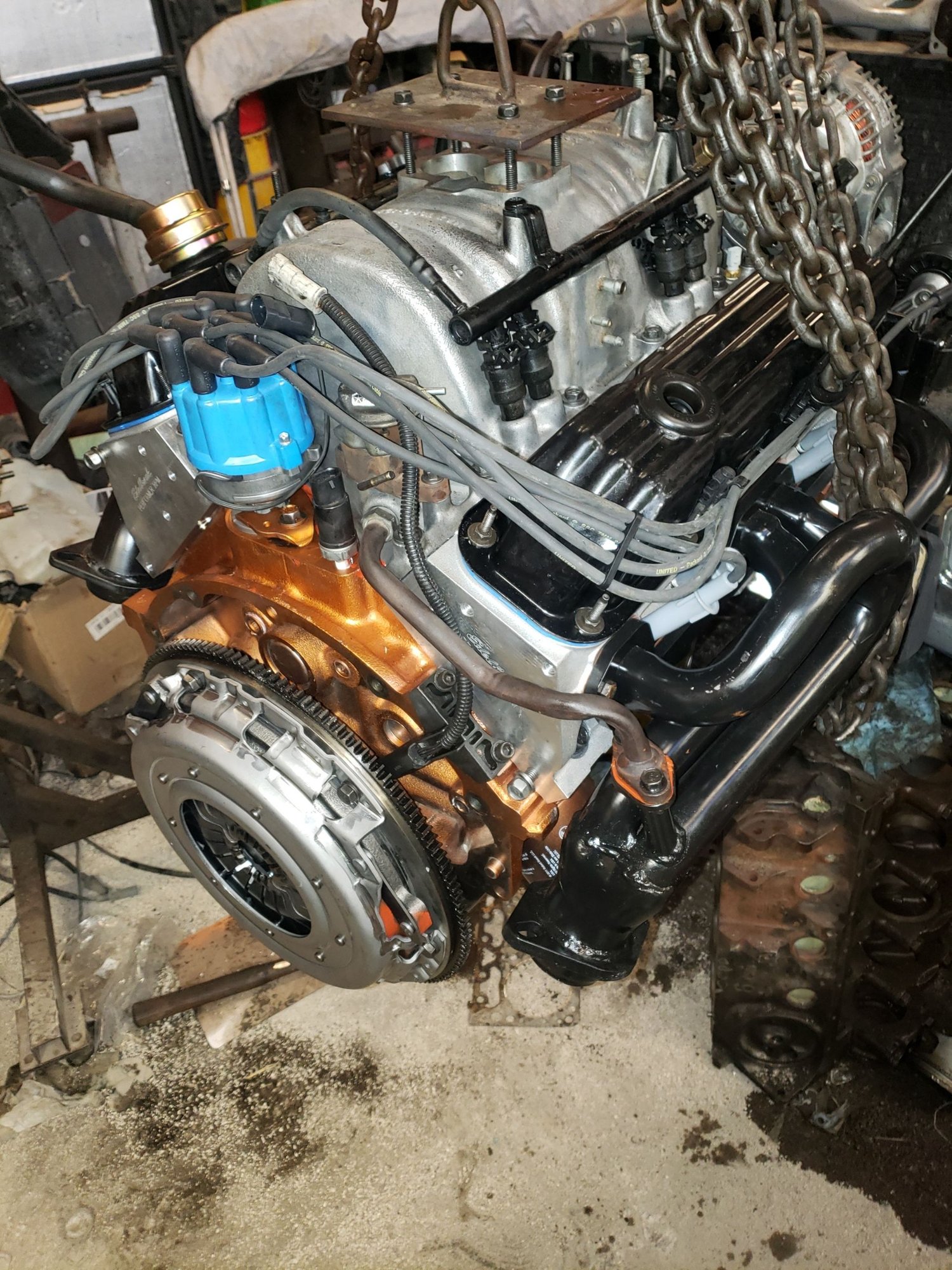

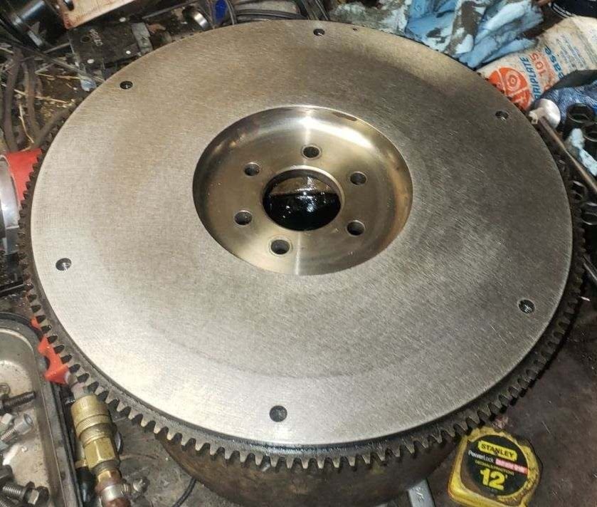

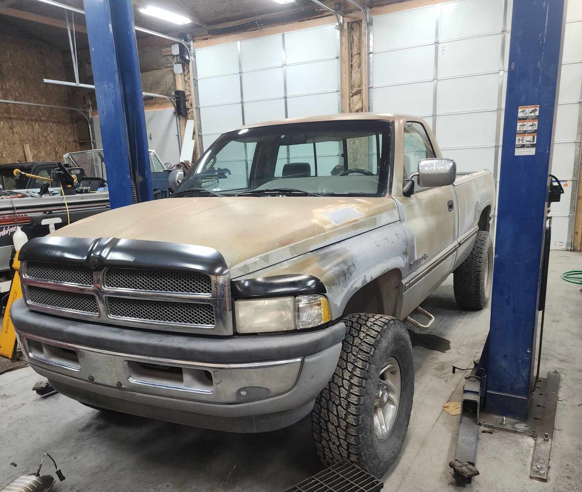

Pics of the engine build for fun and a pic of the truck. I bought it with the 35s and the ranchero shocks or lift not even sure what suspension it has as far as lift or anything. She'll get body work and paint as well.
