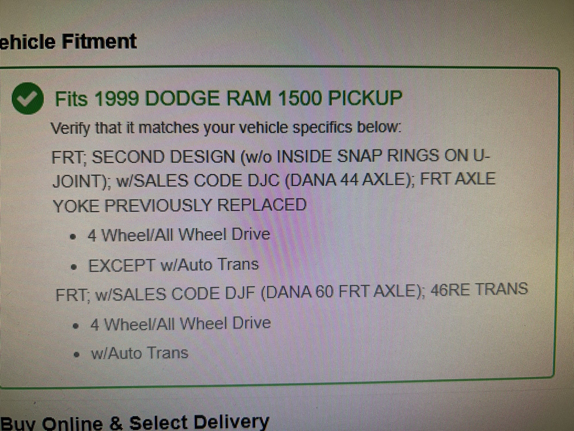

Hi folks, I need to replace my front drive shaft on my 99 Ram 5.2 4x4 w/46RE and when I go to buy one it gives two options.
One is “First Design” with sales code DJF Dana 60 front axle.
The other is “Second Design” without inside snap rings on u-joint and with axle yoke previously replaced with sales code DJC Dana 44 axle.
Does anyone know the real difference here?
Thanks very much!

You have a dana 44 front axle...... Not a 60.

The one for the Dana 44 also says "except w/ auto trans. Thinking it might be for a manual transmission.
