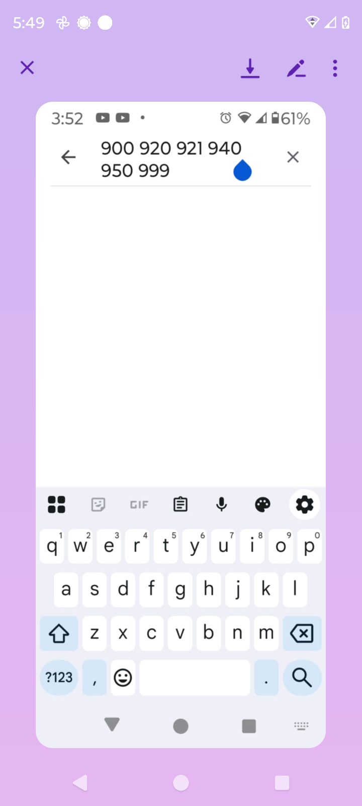

We double checked all the grounds and we replaced the I/O/D fuse . We now reset the odometer and it's flashing these codes
Old Apr 12, 2025 | 06:53 PM
Posts: 87,554
Likes: 4,230
Those are cluster codes, nothing to do with the engine. Basically, they are telling you the cluster isn't getting the info it expects from the PCM...... Perfectly normal.
