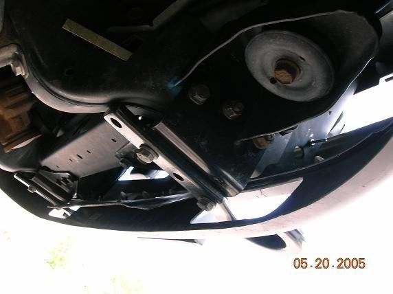

had another look.... Apparently, I have a piece of plastic I don't see in any of the other pics, the covers most of that front crossmember, and I don't see an easy way to get it out of the way...... (explains why I didn't see the bolt holes......)

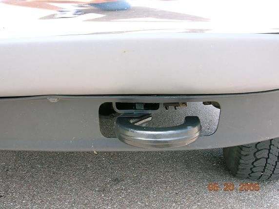

Is that "piece of plastic" the front air dam that extends down from the front chrome bumper about 3" - 5" and wraps around the bottom of the entire bumper? I remember that I had to cut rectangular sections out of it on each side to accommodate the tow hook's forward extension through the air dam.
That one is there, but, there is another piece that lies perpendicular to that, that covers better than hold of that crossmember.... My guess is it's designed to direct better airflow thru the stacked coolers there. (a/c condenser, trans cooler, radiator.)
