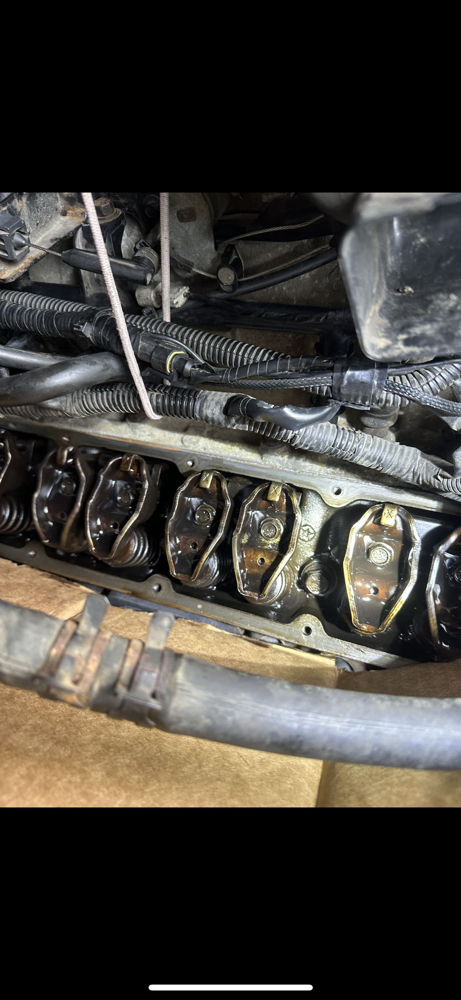

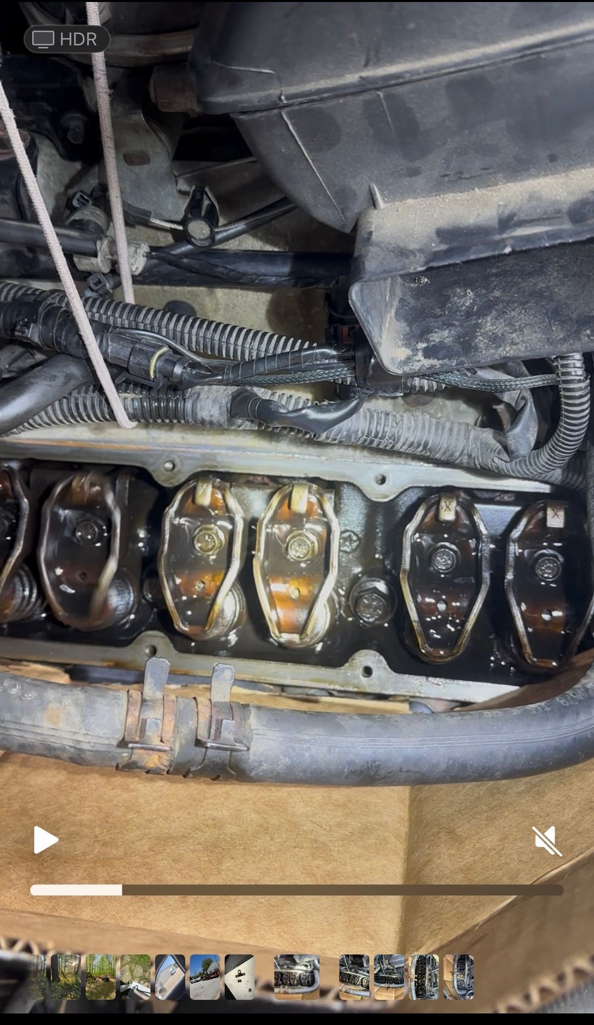

Cylinder 4 is misfiring. The truck has been missing for probably 10,000-14,000 miles if I had to guess. I changed the plugs wires and cap and rotor not long after it started misfiring. There was no change so I then replaced the distributor, with still no change. I didn’t drive it that much so it wasn’t a huge concern, I just worked on it when I could. I replaced the plenum plate a few thousand miles ago. I recently had the balancer walk off the pulley and rub a hole in the timing cover so I replaced both of those and did a timing chain while I was in there. I also replaced cylinder 4 injector recently, and verified good voltage to the injector with a noid light. I knew I had good fuel and spark so I took the valve cover off to inspect the valve train. I started the truck up today with the cover off and it seems like one of the #4 rockers isn’t getting quite as much oil as the others. It took longer to get oil to that rocker as well. Do you think a failed lifter? Pulled the rocker off and can see clearly through the pushrod.
