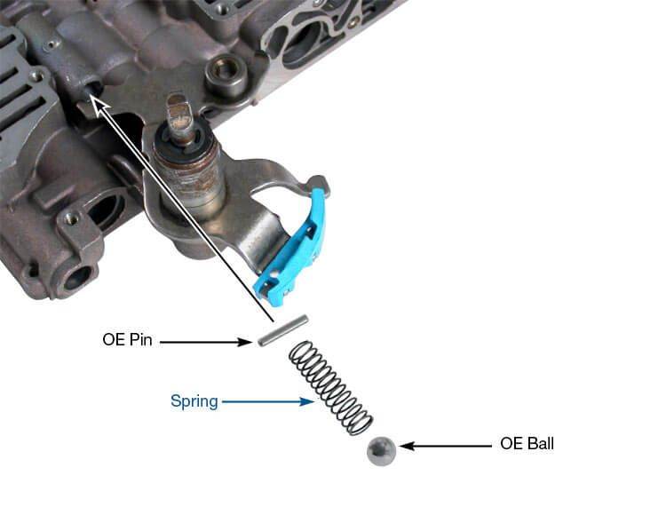

You may want to take the linkage off the shift lever and see how easy/hard it is to move. If it's easy the spring may have broke and not keeping pressure on the ball to hold the position on the rooster comb.
