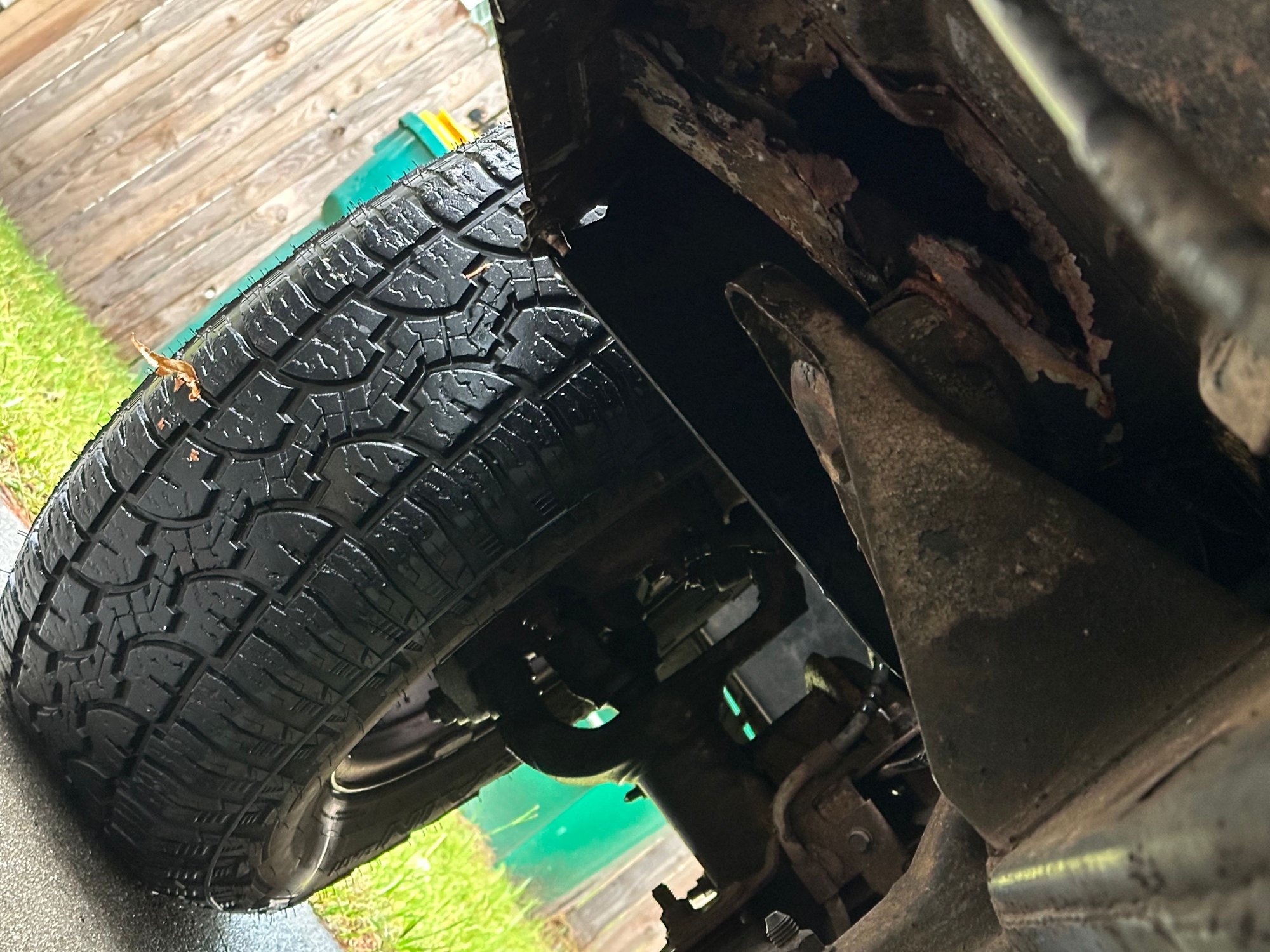

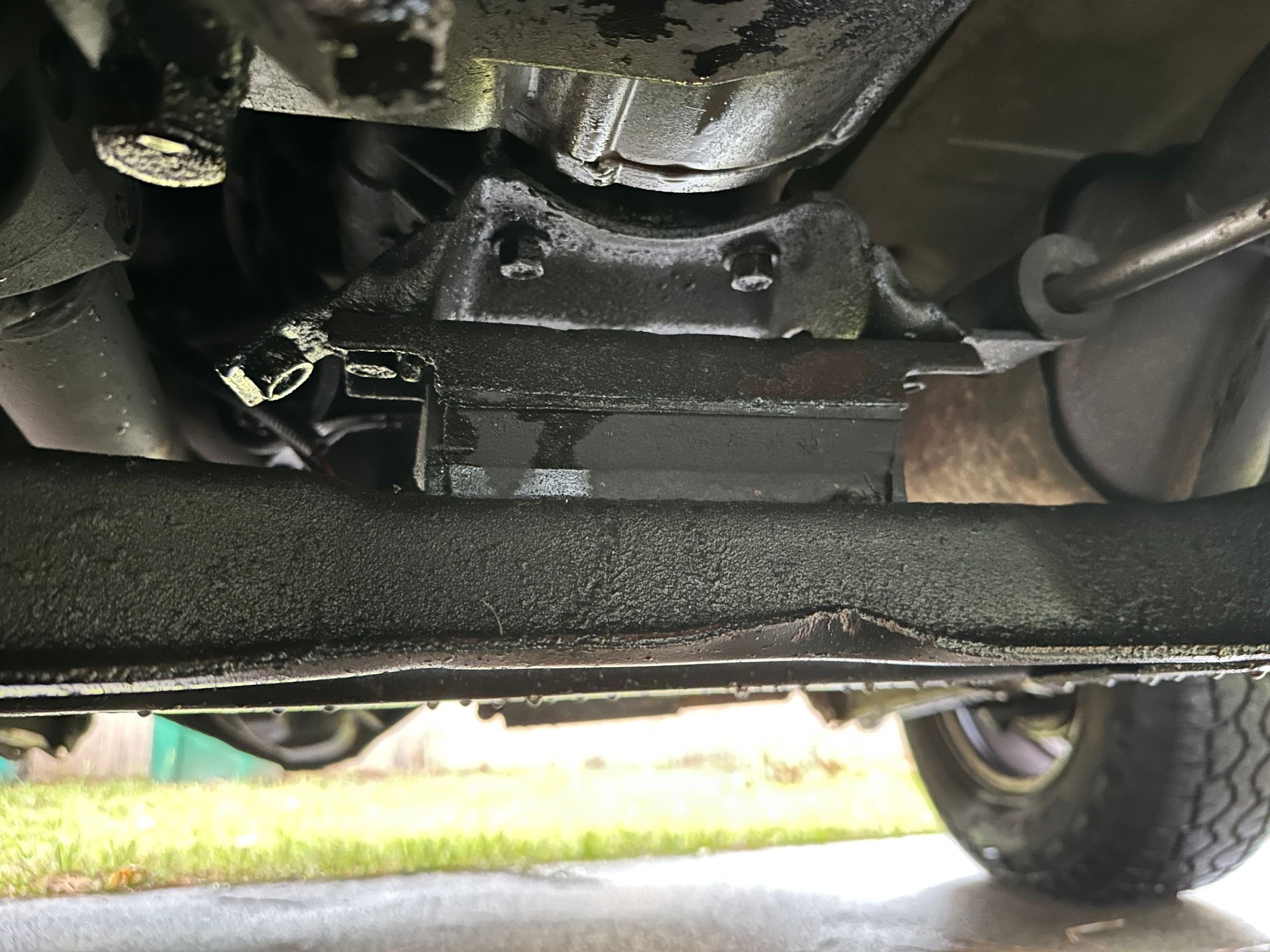

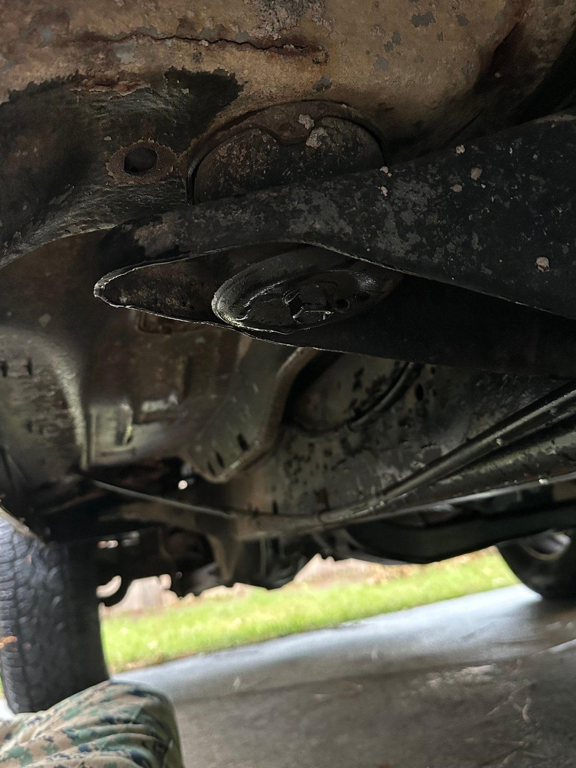

Old Jul 10, 2025 | 04:17 PM
Posts: 87,479
How is the trans mount? Body mounts for the cab?

Jolly John's Avatar
Jolly John
Joined: May 2025
Posts: 11
From: Beaufort SC
Transmission mount
Transmission mount
Driver side forward cab mount
Drivers side mid cab mount
here are pictures of the mounts, the drivers front and passenger front one is definitely a “little” worn down but all the others looked fine, it doesn’t look as if the transmission mount is worn down but I may be wrong
