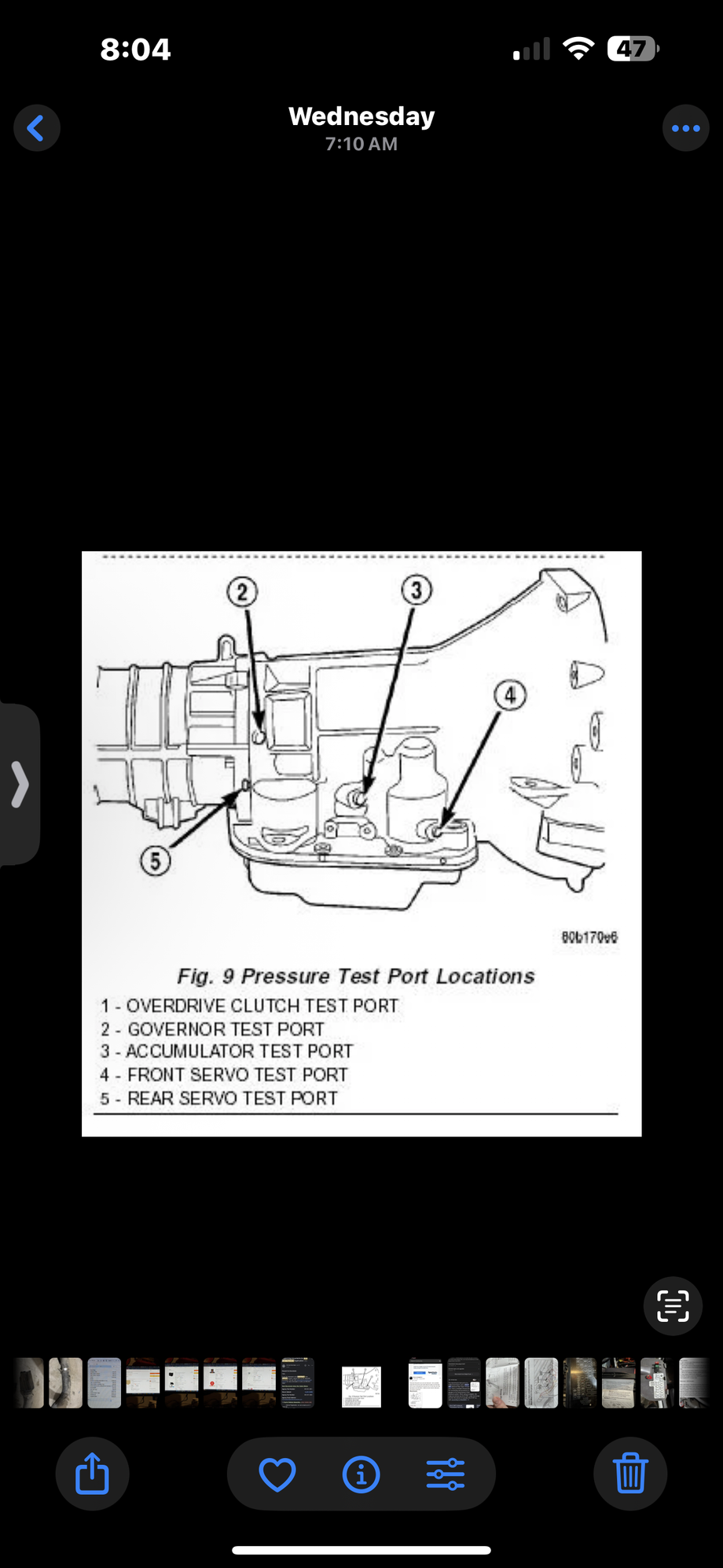

So I got my temp gauge installed, and opted for installing it to the governor test port as I saw that recommended on another forum and a) wanted the most accurate reading and b) didn’t want to hack into my lines. However, after about 15 miles of driving the temp gauge only read about 160F, and seemed to mainly creep up when stopped or in park. Was this the wrong move? Or perhaps is there a better test port to install it in? For reference this is the pic from the service manual I used:

A test port is just that, For testing pressure. It doesn't have flow so you are just reading the temp where it's located. You don't have to hack the line just install a "T" fitting between the trans and existing line.
