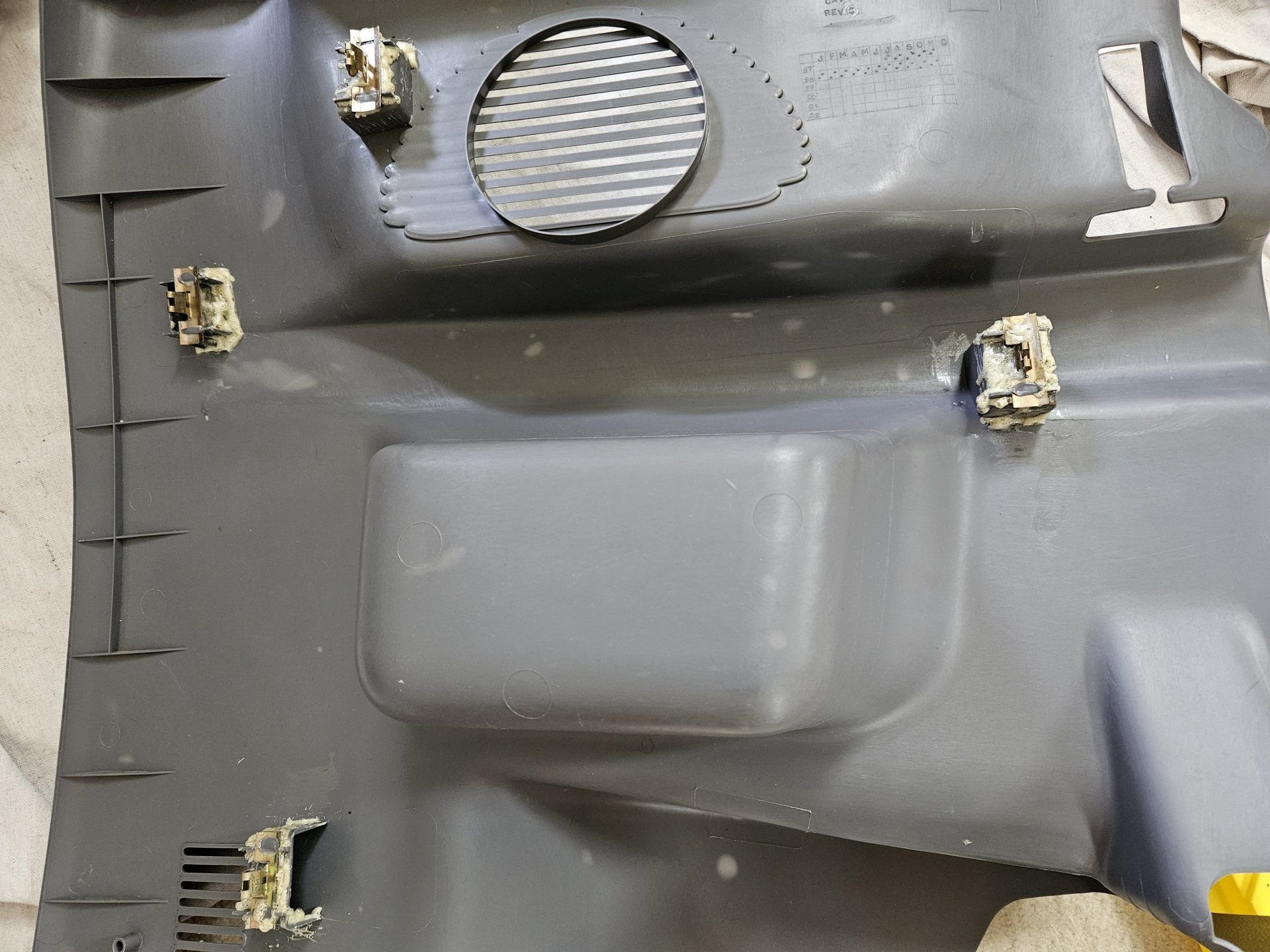

Removed all the trim panels, the rubber flooring, and headliner. For every clip that broke off the a-pillar trim and quarter panel trim, I re-epoxied the clips back. For added measure I got some original gorilla glue and sort of filled in areas to better keep that area more sturdy.

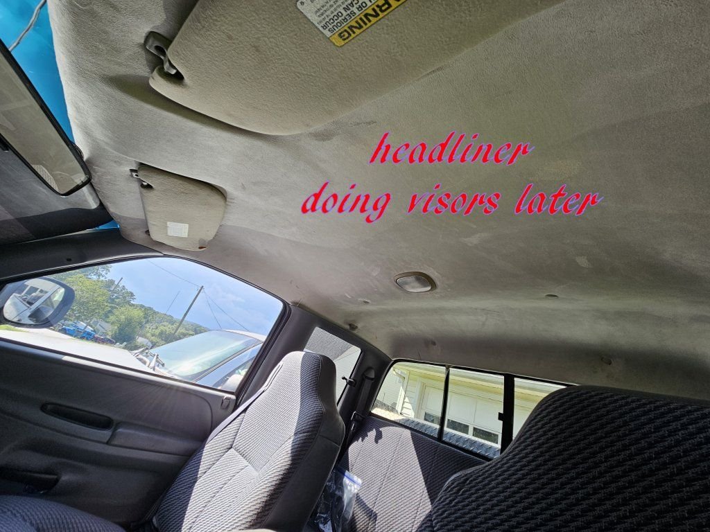

Reupholstered headliner. For club cab, if you buy 92"x60" of foam backed fabric, that will leave just enough to reupholster the visors. Haven't done the visors yet, but looks like the plastic clamshell type so fairly easy to reupholster without having to recut new hardboard (non plastic clamshell type visors)
Headliner cost: $50 fabric, $40 for two cans of 3M Headliner Adhesive. If you have a single cab, you can get by with one can. Extra set of hands is helpful, because once that foam backed fabric touches the headliner, if you need to reposition.. you WILL tear that foam off the fabric.

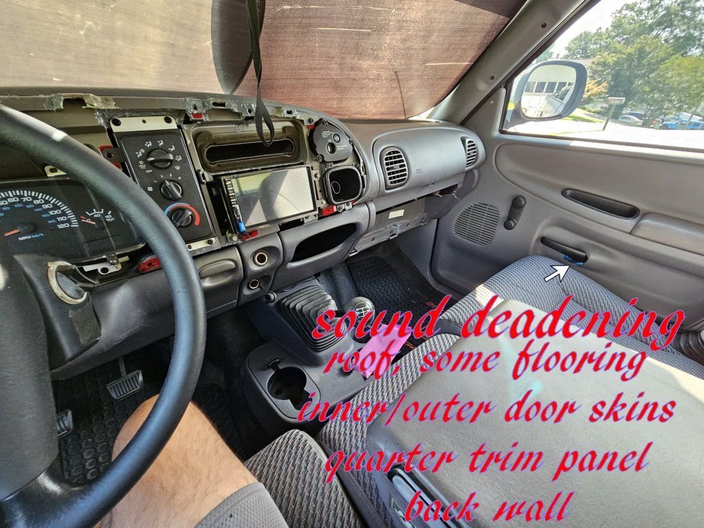

Added sound deadening. Used 72sqft of Amazon Basics. Like the stuff. For a club cab, I was able to do 100% of roof, front doors inner and outer skins 100% coverage. Did about 90% on the rear cab wall. Did 75% on the rear quarter panel cavity where the rear speakers live. Was running out and did maybe 25% of the floor (will do 100% future project). Probably need 100sqft for 100% coverage (not including firewall)

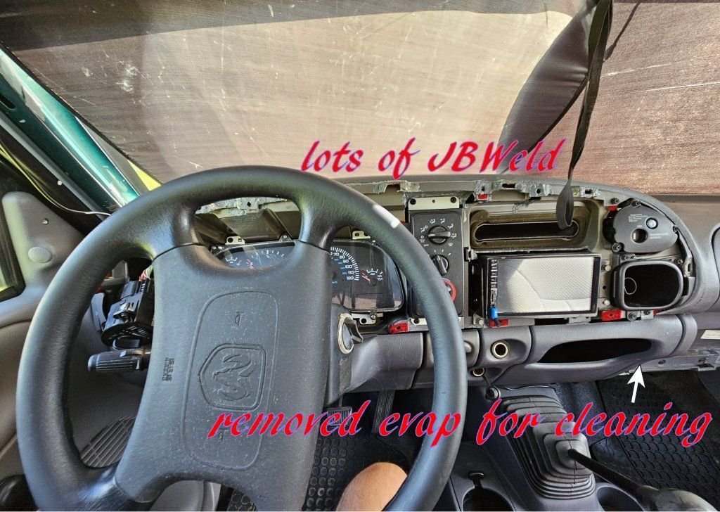

Pulled dash and airbox
Cleaned evap.
Epoxied the broken plastic blend door coupler (fingers crossed)
Sanded blend door top pivot location - was seized up from corrosion and caused blend door couple to break.
Added new weatherstripping to condensate drain, heater core outlets, evap outlets.
Cleaned out airbox.
Used 1/8" thick EPDM weather stripping on the recirc/fresh air door. May block the fresh air at the port in the cowl, and keep it like that if I don't have fogging issues. May get Geno's cowl filters... or make my own weatherproof filter at the fresh air port inside the cowl.
Stopped there for the day because I needed to epoxy the blend door coupler and let it cure. Would be harder to screw down that actuator when the airbox is installed. Also had drilled the bottom of the accumulator to let the oil drain so I can measure how much I need to add as I'm using a new accumulator. Might do a youtube on cutting that sucker apart to show how it works. Less than 1oz drained out, so probably add 2-3oz, the standard amount for replacing accumulator (dessicant bag will retain some oil, too)
I got some asphalt based stuff and did most of the interior. The roof got that plus some insulation(black truck). Definitely noticed the difference compared to stock.
What color did you get? The stock gray is unacceptable so mine had to be black. I made the mistake of assuming that the 54 inch stuff would fit. It does not for a club cab. You can modify the rear(under the arm rest) to fit 8" subs.

I got ... light gray.
Amazon Amazon
they have the Black option. Black would be really good for night driving to absorb stray incoming headlight beams.
Headliners are pretty stressful - no do overs. my neighbor had to go out of town so couldn't get me a hand. Should have waited so he could hold the fabric up while i smoothed it out. Harder to smooth to the contours solo. Accidently a bit of the fabric touched the headliner near the visor, no where near correct position so had to move (tearing the foam off). two creases behind each front door, and was a bit too stretched where the rear plastic nut attaches to the headliner, so I didn't press the nut all the way in.. looks ok.

The trick is, take the cardboard backing out, lay it on the floor, spread you glue, then lay out the fabric. And yes, a second set of hands it pretty much a requirement.

Yeah, I removed my headliner from the truck. I wouldn't even think of doing it in the truck. Of course it's a pain, Have to remove the seats, trim etc to get it out. And it's not cardboard it's a thin molded fiber(glass)board. But they may have changed that through out the years. And if the existing headliner is bubbling or starting to fall you have to remove all the old fabric and foam before installing the new.

And with 2nd gen, you'll probably break off some of the metal clips securing the trim panels (a-pillar, quarter trim panel). Started with epoxy and then used original gorilla glue that foams up to reinforce the plastic around the clip. Like the dash, specifically engineered to not often break during dealer servicing in the warranty period
A 3ft screwdriver with a wide flat head tip and a guide to locate the clips hidden back there would let you get most off without stressing the plastic and breaking clips off. I had neither. On the 2dr club cab, there's no way to access the top rear clip that must be removed to get headliner out whether removing the quarter trim panel or just loosening it, gonna break.

Got everything put back together except the instrument cluster bezel and glove box. Been JB Welding little pieces of the subdash to give the bezel something to clip to as well as the dash top being able to screw to the subdash. Had to JB Weld a metal rod for a missing glove box hinge pin. The other 2 hinges were slightly cracked so JB welded them for support.
Rear quarter panel trim - didn't have a metal clip aligned to its hole and pressed bending the clip and breaking it out of its epoxy. Was able to epoxy it back without removing the panel and it's fitting snug now.
All 3 clips broke on the driver a-pillar trim. Crap epoxy. Even after I dropped the dash because I can't fit the pillar in with the dash in the way. I think in later years instead of the a-pillar trim having 3 clips, it has tabs that slide in holes so you can install without dropping the dash. This JB epoxy and Gorilla epoxy are pretty weak...going back to JB Weld original. Going to omit the bottom clip as I'm not dropping the dash yet again. The middle and upper clip will have to do.
Had to do a lot of JB Weld on the headlight switch subdash and climate control board.... the subdash these attach to were shattered but found most of the pieces.
Have to rough up plastic surfaces with sandpaper to get good adhesion. When fixing subdash cracks, you not only have to fill the cracked part, but you need to strengthen all around the crack so a new crack doesn't form outside of where you've glued it back.
When needed to hold piece in place, used a combination of aluminum HVAC tape or plumber putty.
Found a tube of JB Weld PlasticWeld putty in a ziploc bag and it's still soft. Might give that a try for some of the bigger gaps I have left that are hard to fill with JB Weld original.
Just for the interior, wound up using 3 packs of epoxy (the type with 2 connected syringes) and a pack of original JB Weld. And a 1 oz bottle of original gorilla glue (to strengthen the plastic area behind the clips for the rear quarter panel trim and a-pillar trim.
Finding epoxy just too weak. One funny instance was I mixed the 5 minute epoxy inside, walked out in the sunny june heat and the epoxy started reacting and solidified from the sunlight before I even got to the truck... became scorching hot from the thermal reaction.
Sticking to JB Weld original for this kind of work. Should have just got the 10oz of original JB Weld for all this work. It sets very fast in a hot truck. Did the glovebox hinges 2 hours ago and feels really solid, but waiting til tomorrow to put the bezel and glovebox back in.
