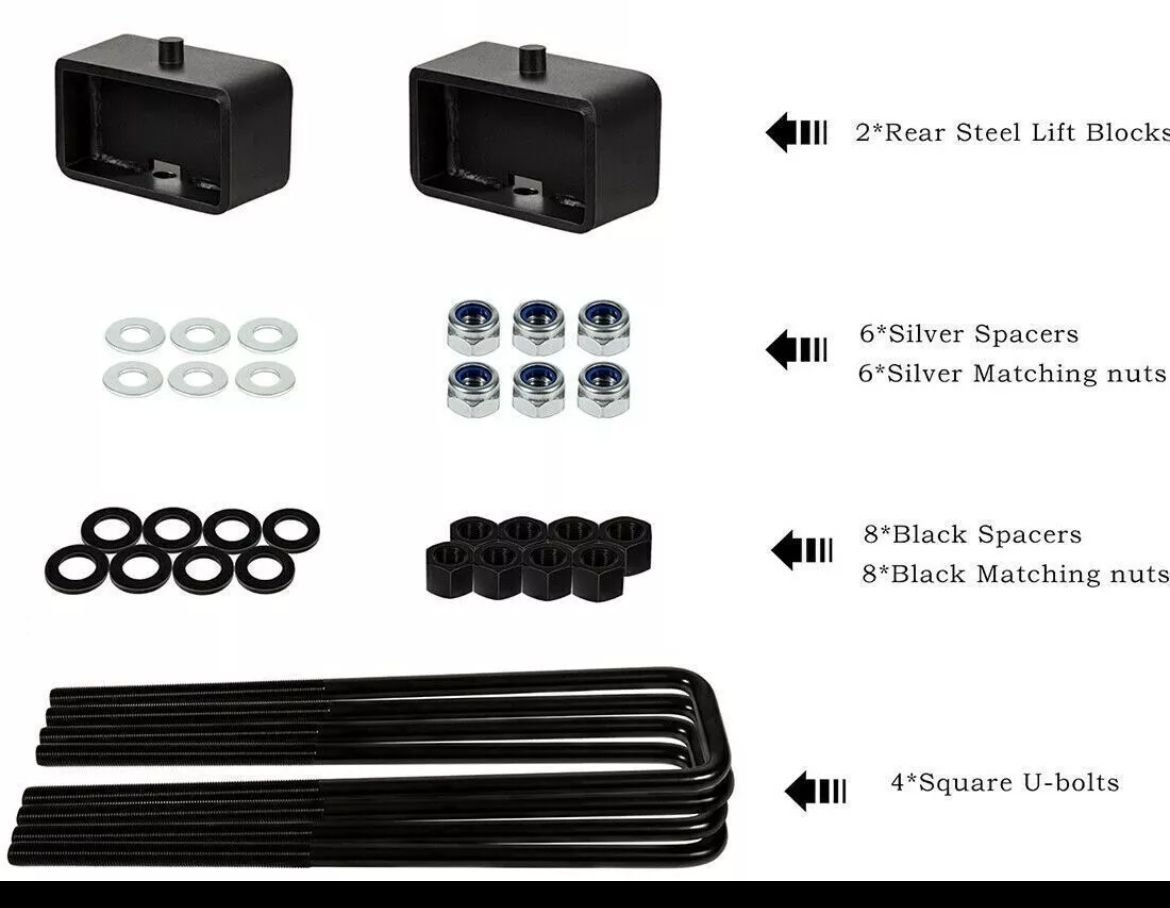

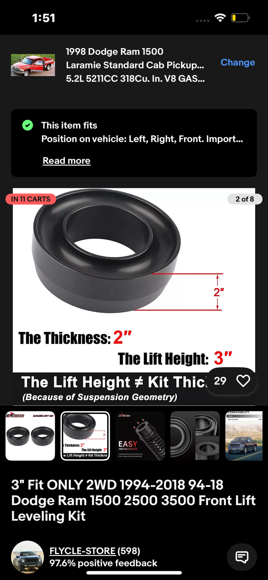

I installed a 3” lift on my 2wd truck. 2” spacers and 2” block. Both ads claimed a 3” lift.
I believe I either need longer shocks or shock extenders because it’s pretty rough going over speed bumps and it doesn’t take rougher roads too well.
The speed bumps are the worst. It’s almost like it’s there isn’t enough give. Just a hard jar.
I’ve searched everywhere to find longer shocks that will fit my truck, as well as shock extenders and I can’t find anything. The longer shocks I’ve found are for 4WDs and the extenders are for everything but my truck.
any advice? I saw 1 guy on YouTube that used extenders, but the link he provided no longer exists on eBay.
also, should I upgrade any other suspension parts with such a high lift? Driveshaft, control arms etc?
