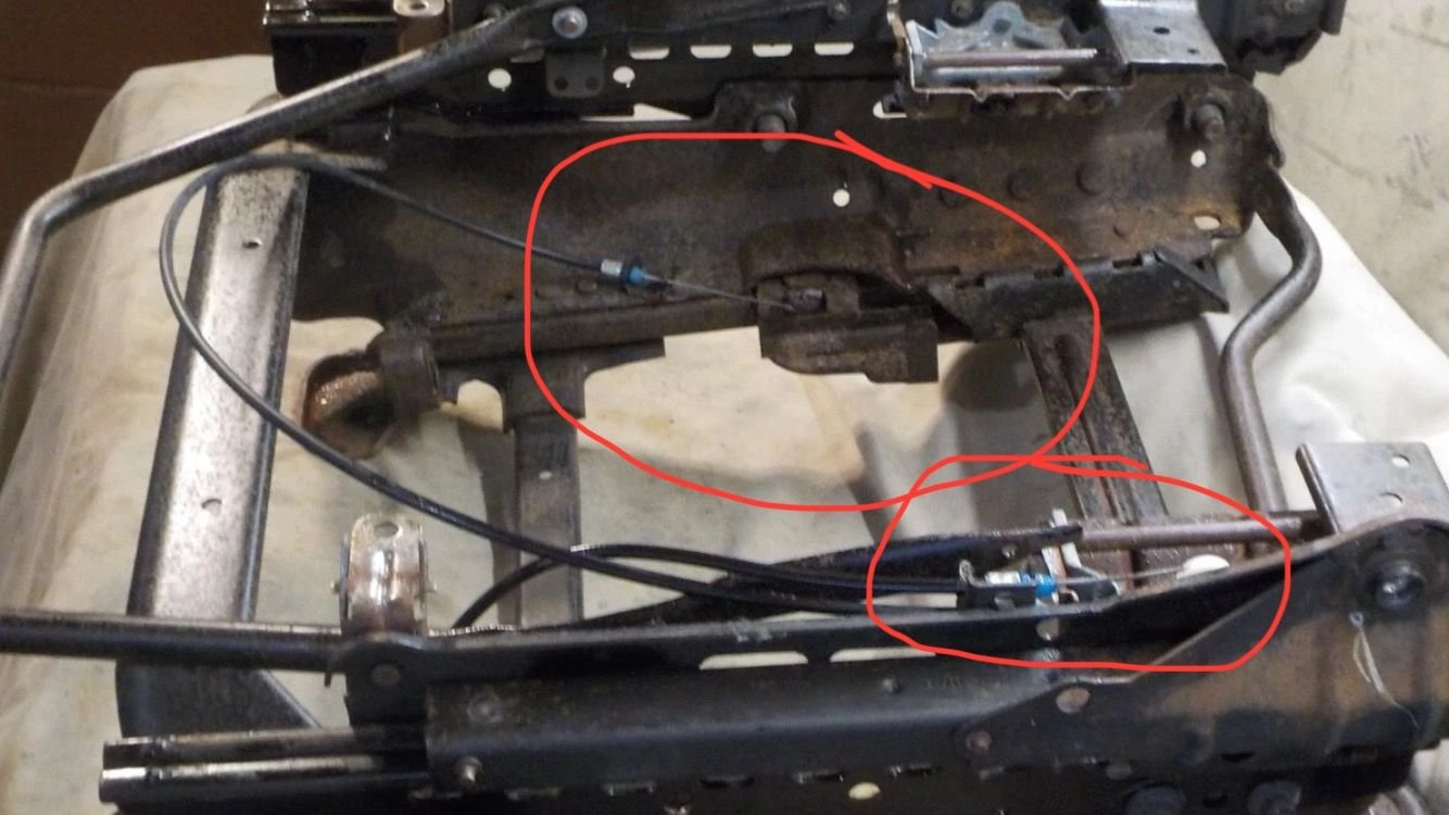

This is the part I’m talking about:
It looks like there might be adjustment at the smaller circle. I will have to pull the cushion sometime to get a better look and to clean everything, too.

The lower passenger seat slide is not in any way connected to the quick seat release. It is entirely dependent on the passenger seat back being tilted totally all the way forward. As soon as the passenger seat back is moved slightly back to normal position, the lower track locks.

I got it fixed. There is no adjustment in the cable, and it had definitely stretched just enough to not totally disengage the locks. I pulled the seat cushion, and there is a white plastic pulley that the cable runs through. It is attached to the seat’s back, and it pulls the cables when the seat is reclined forward. I flipped the pulley so that the cable crosses once, and that shortened it enough to pull the locks.
