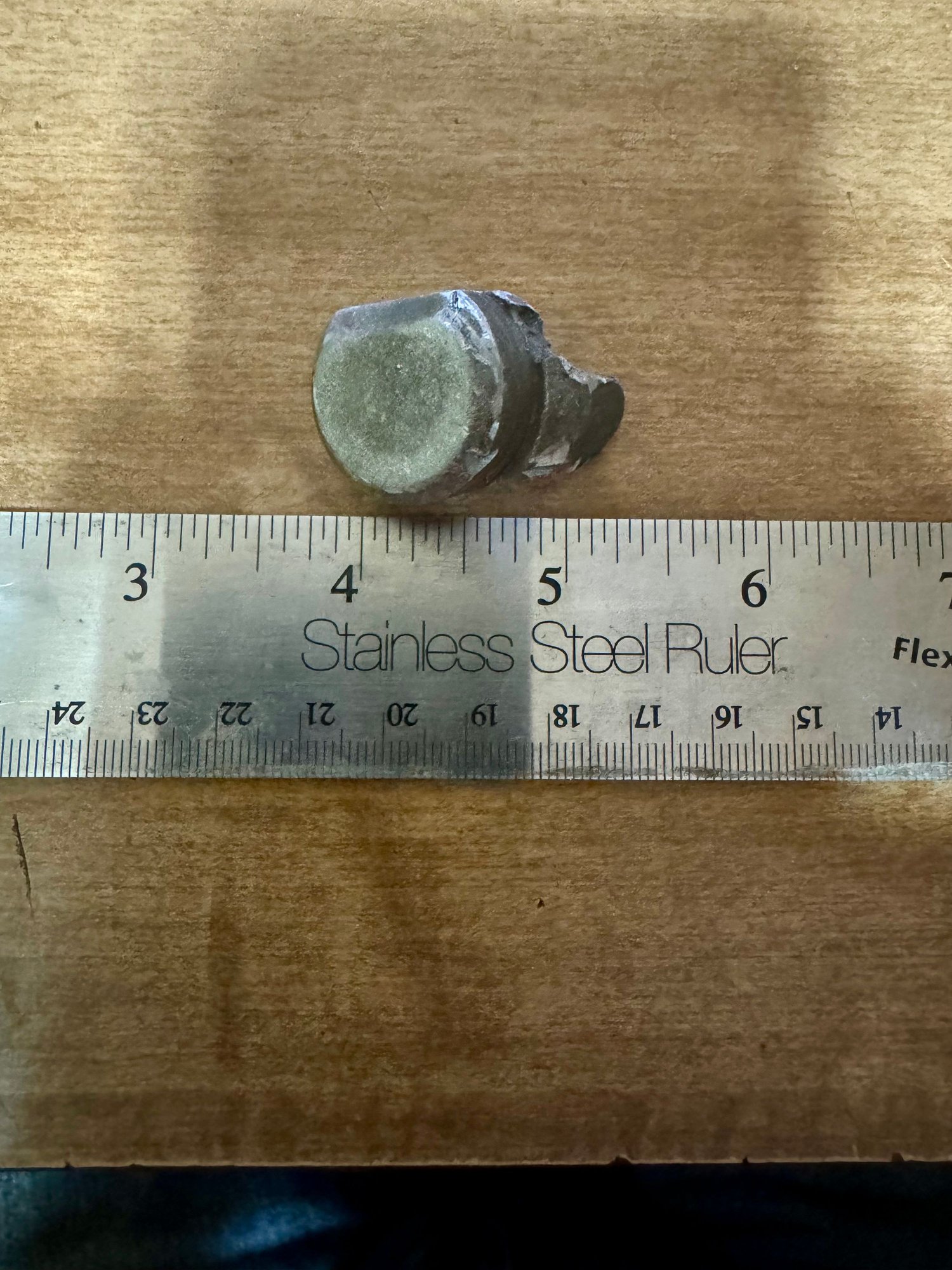

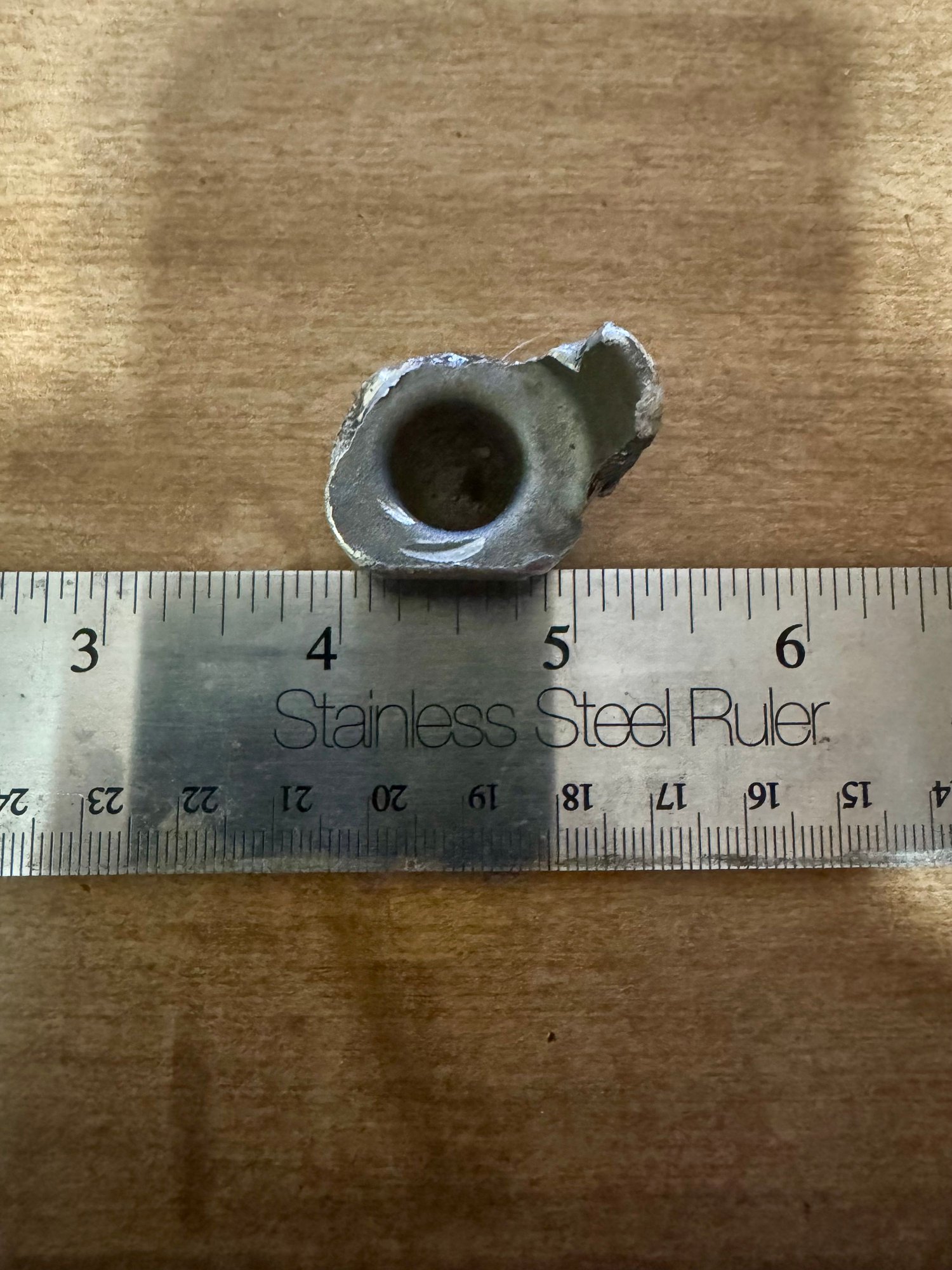

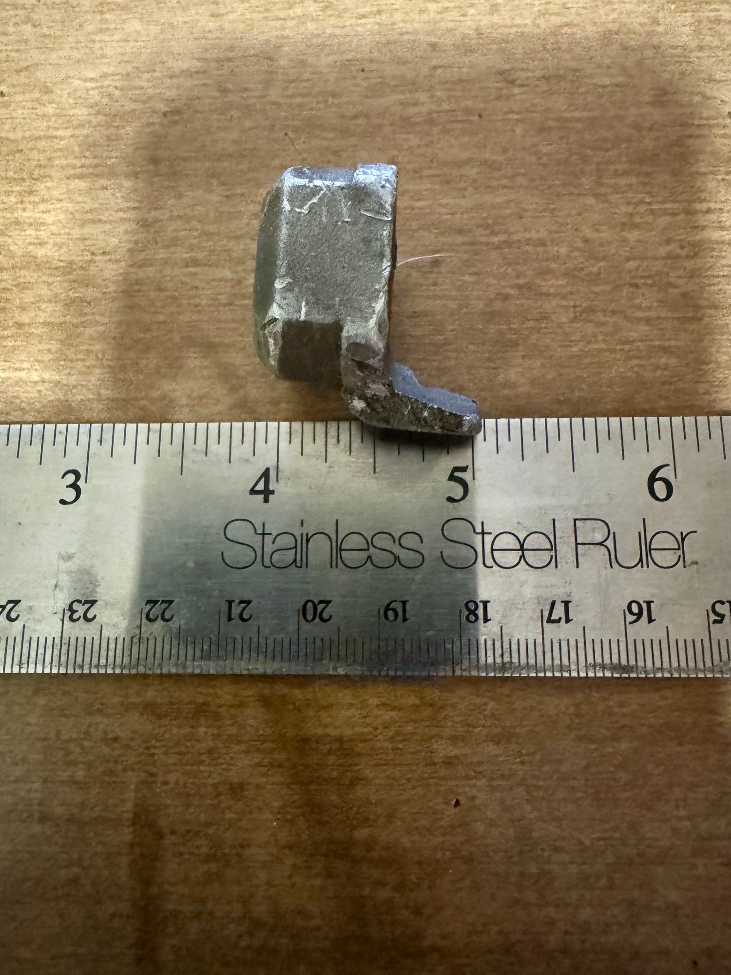

I do have another interesting question though… anyone know WTH this is? When I pulled the torque converter it was laying in the bell housing. It’s been there long enough to have been rubbing against the torque converter, but I can’t tell where it came from.

Looks like an alignment dowel..... that was apparently cast into the trans housing? Usually they are just a metal pin in a hole in the engine block.... Has the trans ever been out of the truck?
Yes, when I first got the truck 12-13 years ago I had a shop rebuild the trans because the previous owner thought it was a good idea to pull 5th wheel cattle trailers with it (it’s a 1/2 ton). About a month after I bought it the trans completely went out. This is the first time since then that the trans has been removed. I couldn’t locate anything on the front of the housing that looked like something had broken off from it. I was looking all over that housing lol. Really confusing.

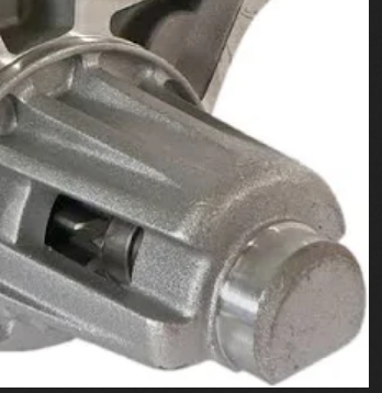

To me it looks like the end of a starter.
Oooo, Very good. Right shape too.
