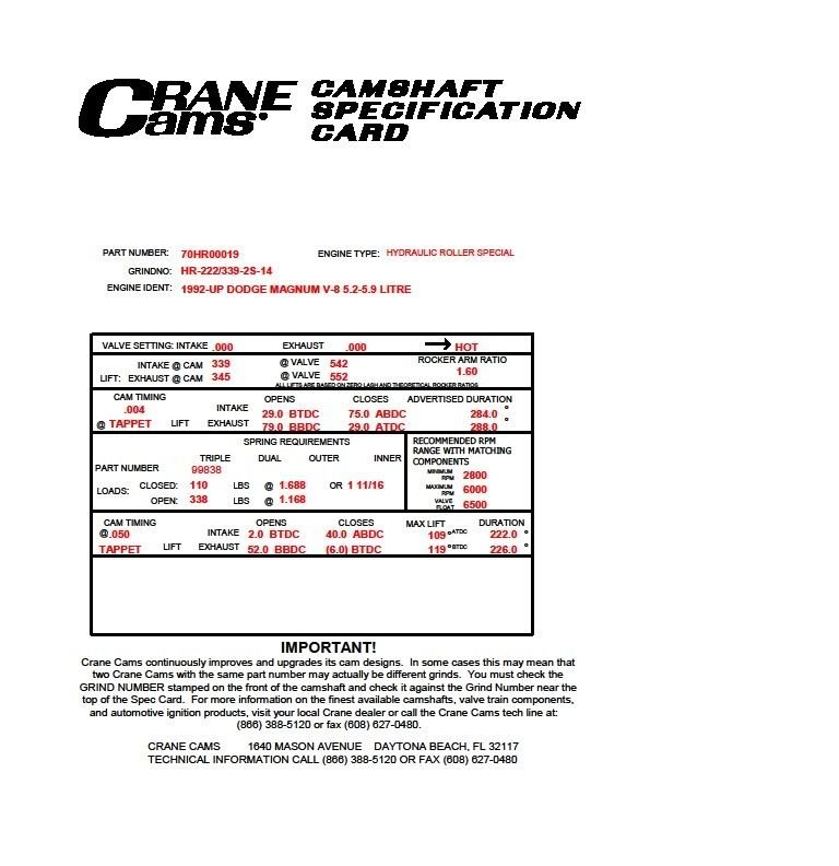

I’ve had this crane cams cam for like 13 years and now I’m thinking about putting it my my 98 ram 1500 5.9 4x4 but I want to know if yall have ran this cam or one similar I’ve attached the cam card.

It's power band is 2800-6000 so that will kill your low end. M1 intake, long tubes and a tune will be needed to get the most out of it.
Not to mention a high-stall converter...... Not really a truck cam.....

That’s kind what I was thinking just save for my 2wd build eventually
