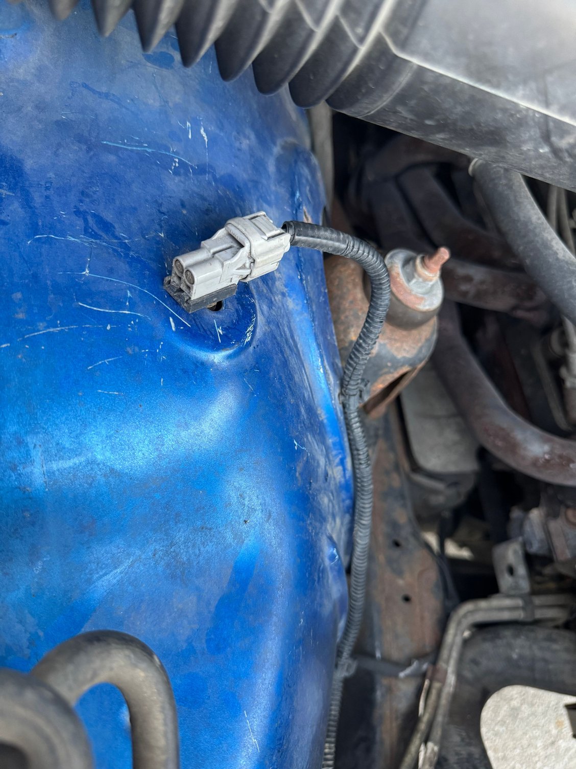

Does anyone know what this wire goes to? It looks like it is capped off. Somehow I just now noticed it after all these years.

May be for an option that you dont have.

Pretty sure 4WABS

I have every option on my truck from the factory except for 4 wheel ABS, and quad lights (sport model), this plug isn't used on mine either.

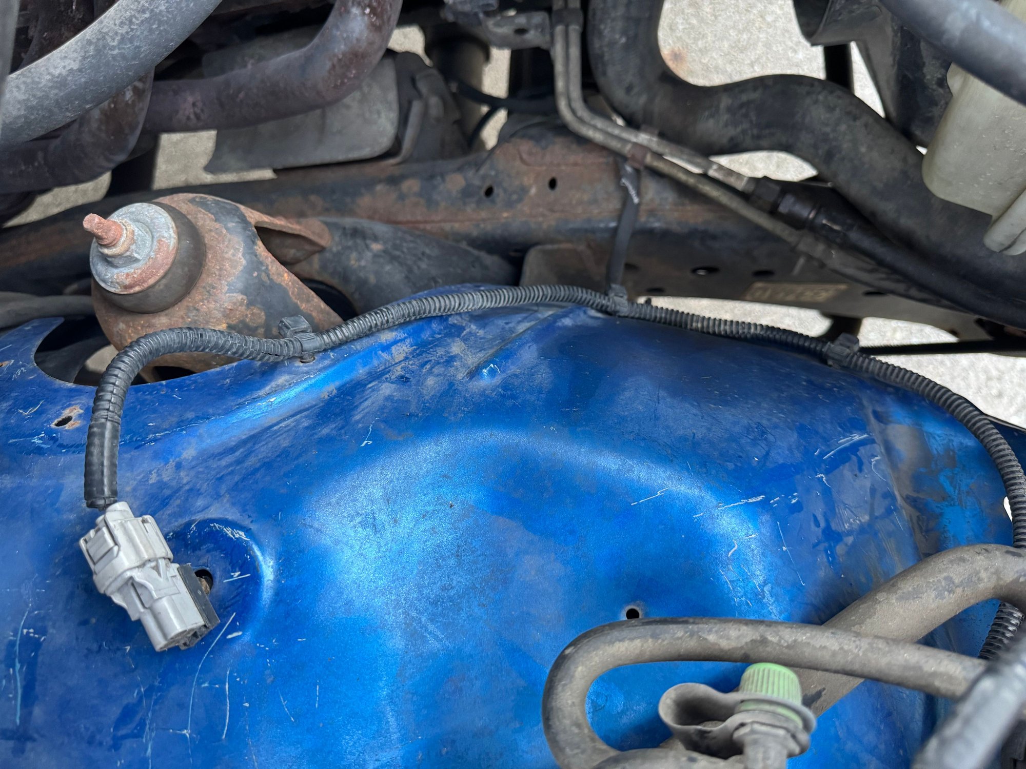

Correct, that's the connector for the front wheel ABS sensor. There is another connector on the driver side below the brake lines.
