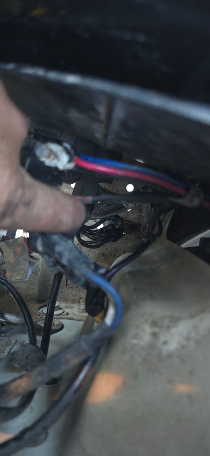

So I jumped the relay and it's showing .41... still tracing

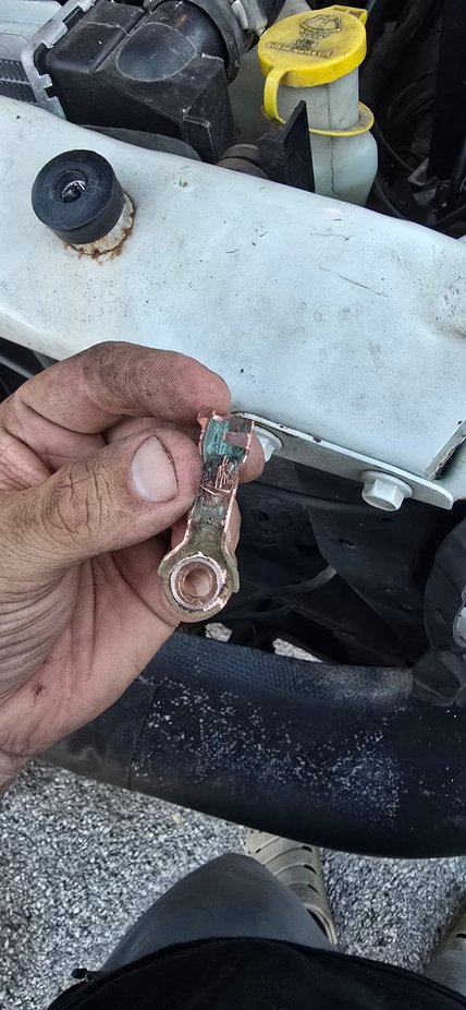

I wanted to follow up. Found the ground under the battery. It was shredded. Reconnected everything and rewired. Fuel pumps working again! What a pain. Thanks everyone!
Onto the next issue.

Yep. That's what mine looked like too.
