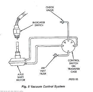

Do you have any issue with the hvac vents? If so your check valves may be bad. Check the vac before going to the t case switch then check it at the cad. Should be about the same, My line got water sucked into and clogged with rust. Definitely check the metal lines.

The remedy for my truck:
my axle shift motor (vacuum diaphram) was not holding vacuum. So i replaced that, but no luck. Then I replaced the control switch on the transfer case. The control switch was my issue. When I replaced the control switch the 4wd started working, the 4wd light/indicator on the dash started working and it also fixed my A/C vent selector.

You should see vacuum on one side or the other down at the metal lines going to the cad, so long as the engine is running. If you don't have vacuum at either, then your vacuum source is the issue.

Check the big rubber plug at the vac switch -- they love to fail, at least in our arid environment. You can still get the entire harness from motor to t-case and it's not even that expensive

The check valves will hold vac from the motor. At idle you have the most as soon as you open the throttle it drops. if you fallow the vac line from the intake(#1) to behind the fuel rail it will come to a "T". One line goes to the the hvac and the other goes to the t case. If you have good vac there and not at the cad the problem is in between somewhere. Check it a the rubber lines where they connect to metal tubes and see what you have.
