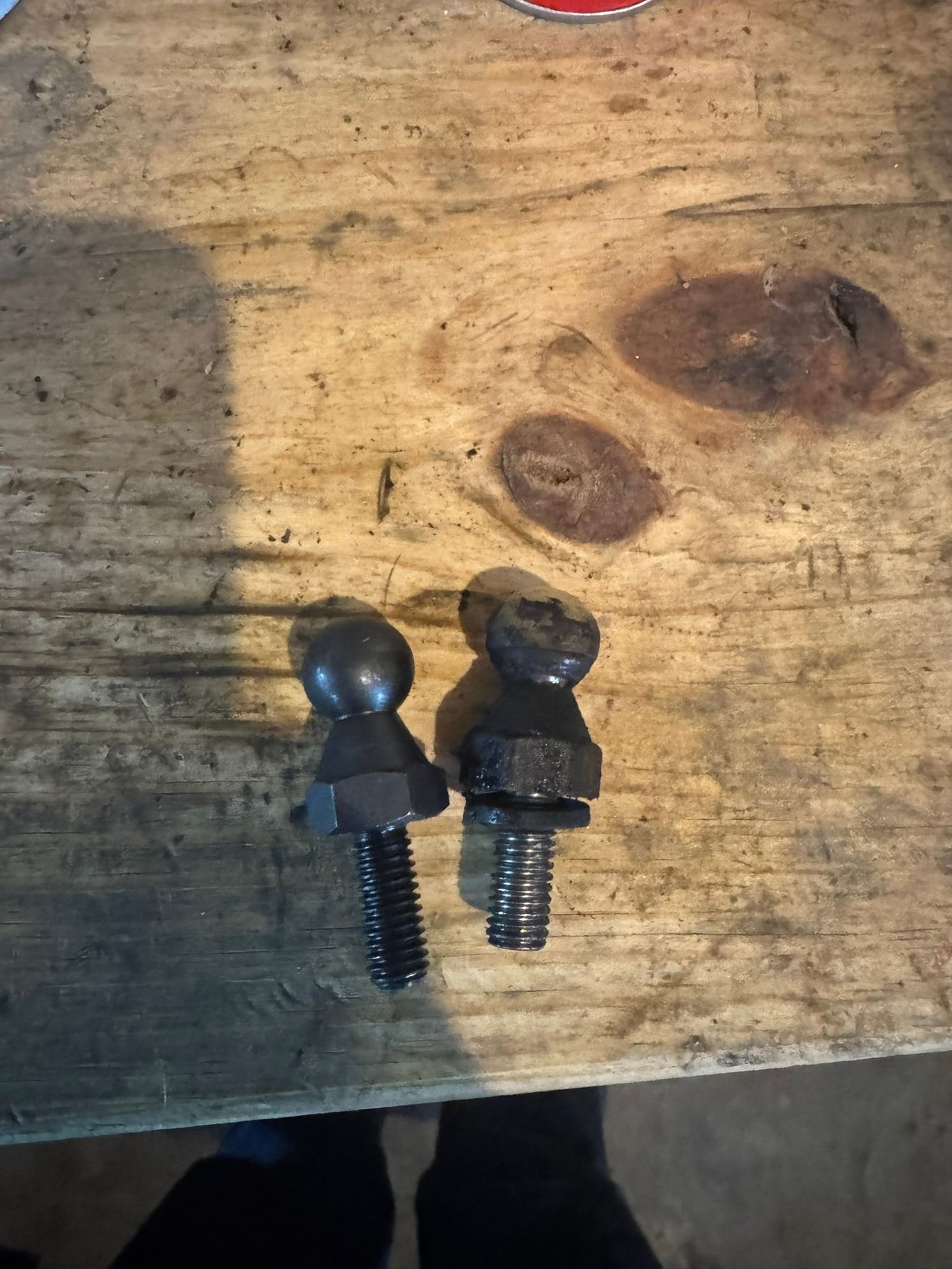

Old Jan 31, 2026 | 04:29 PM
MarineEngineer's Avatar
MarineEngineer
Joined: Oct 2025
Posts: 14
I am back with an update, I can confirm that a NV4500 Clutch Fork Pivot is the same as a NV3500 Clutch Fork Pivot. I sourced an all metal one from Ebay. Did my clutch yesterday and swapped them out with zero issues.
