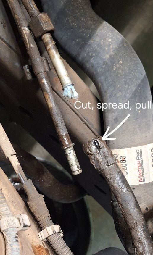

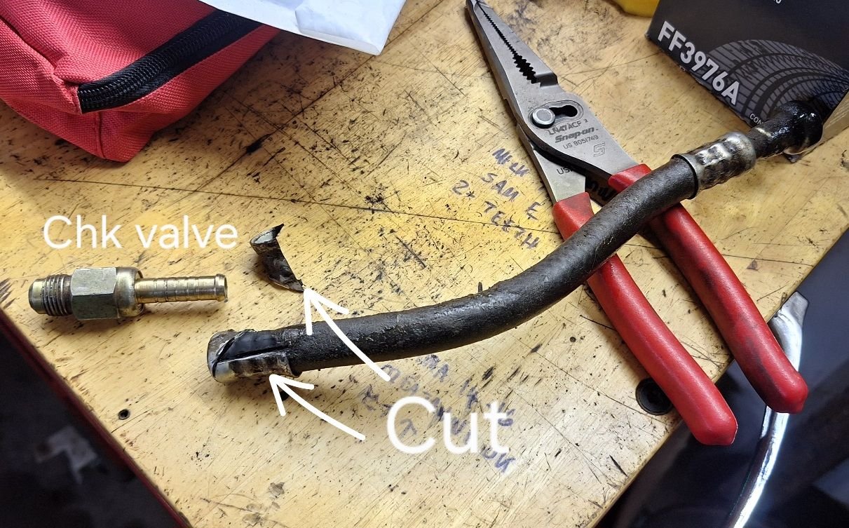

Ok @Moparite this is really easy as I had hoped. For parts, all you need is 3/8" tx line and some clamps.
Just cut the crimps and pull the hose(s) off. Cut the metal sleeves. On the check valve, the valve itself is beautifully barbed for a hose. It was so elegant I opted to keep it and thru-drilled it. The other three connections have to slip over a flare and it's TIGHT, but once you get it you likely would not even need hose clamps!

Basically, cut, push, clamp. I did not bother double clamping -- feels very unnecessary

Thanks so much for the pics, Just the info i wanted to know!
