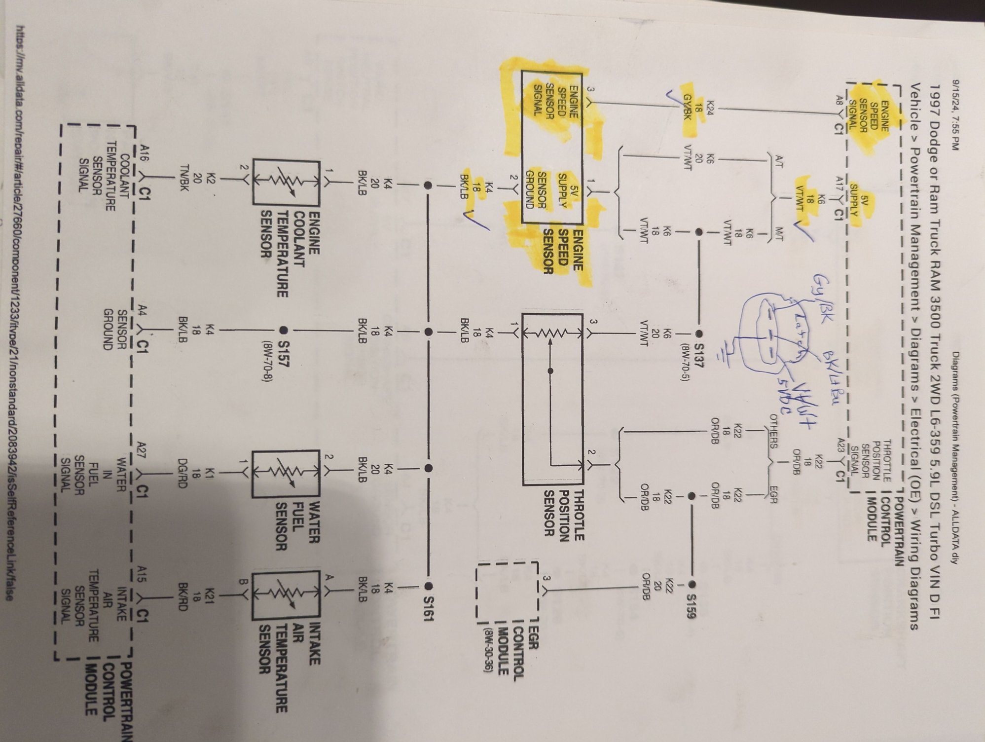

Found the ESS (Engine Speed Sensor) and traced the wiring using this diagram. Colors matched up and there was a 3-wire connector about a foot up from the sensor, so I unplugged it.
Tested for Hot or Ground on all 3 contacts with engine OFF. All 3 showed continuity to Ground.
Tested with Ignition in ON position: The Hot contact (5VDC) was indeed Hot; the Ground contact was Grounded; nothing on the Signal contact, so...
Traced the Signal wire using a Telecom tester (Signal Generator and Probe) and it traced right back to the PCM, like it's supposed to.
So. Wiring seems ok! Then what in the world is going on?
This wiring checks out. So what's up?
