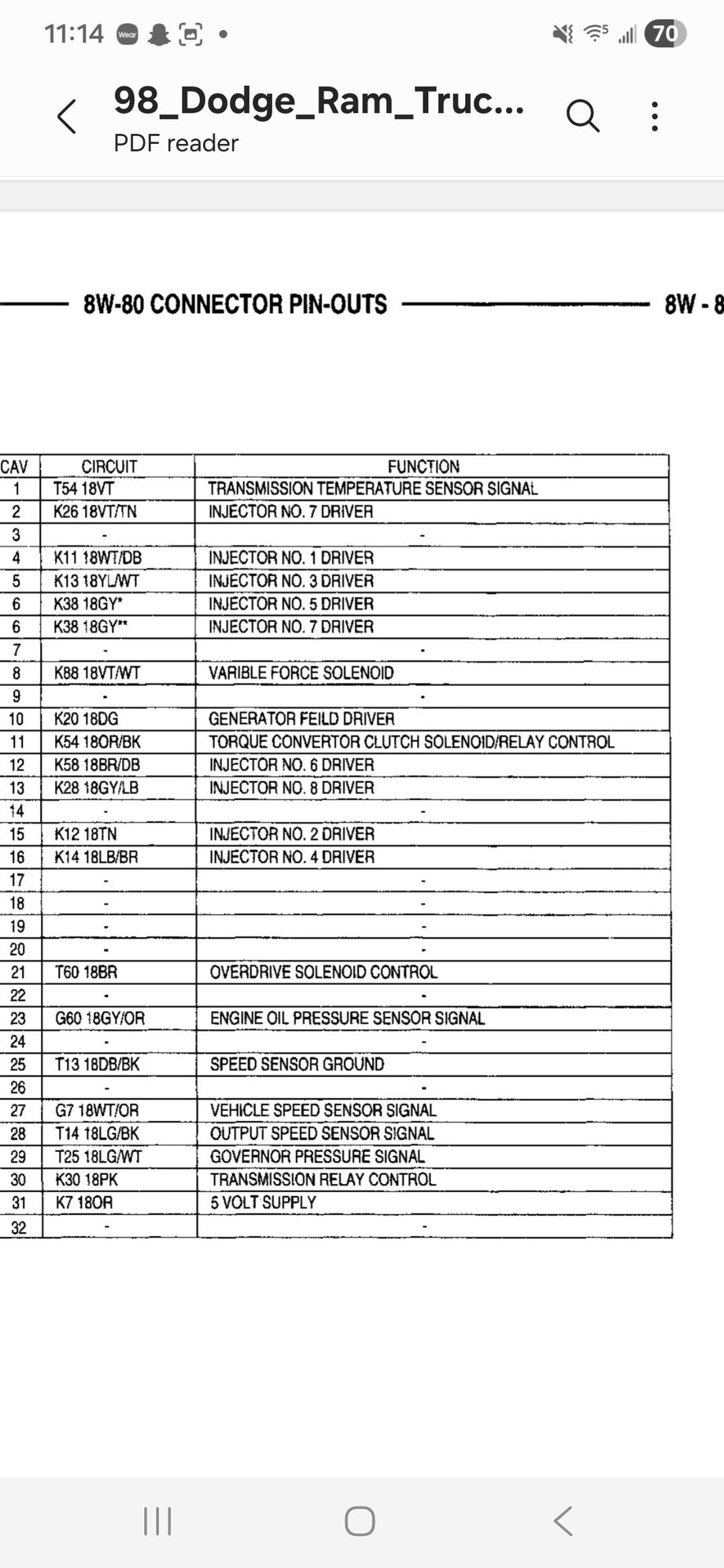

Okay, Ive formed an idea. So when I wired in the injectors for 7 and 8 had to replace the connector because it kind of just fell apart. So there's a good possibility that those pin outs I wired them wrong, so I think if I get a new ECU and a new connector for that. And redo it all and make sure double check triple check. It's all wired correctly, it should be okay. And my a b s and brake light should go out with a vin correct ecu.
As you can see the overdrive and lockup pins are infact located in this pcm connector, along with the vehicle speed pin which I know has something to do with the brakes and abs stuff.
