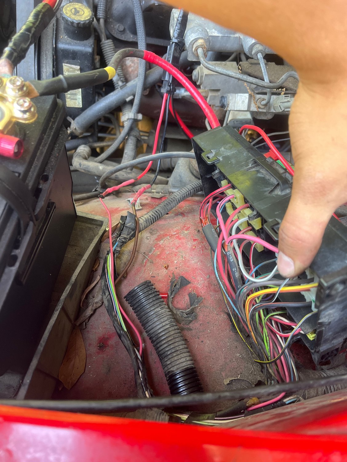

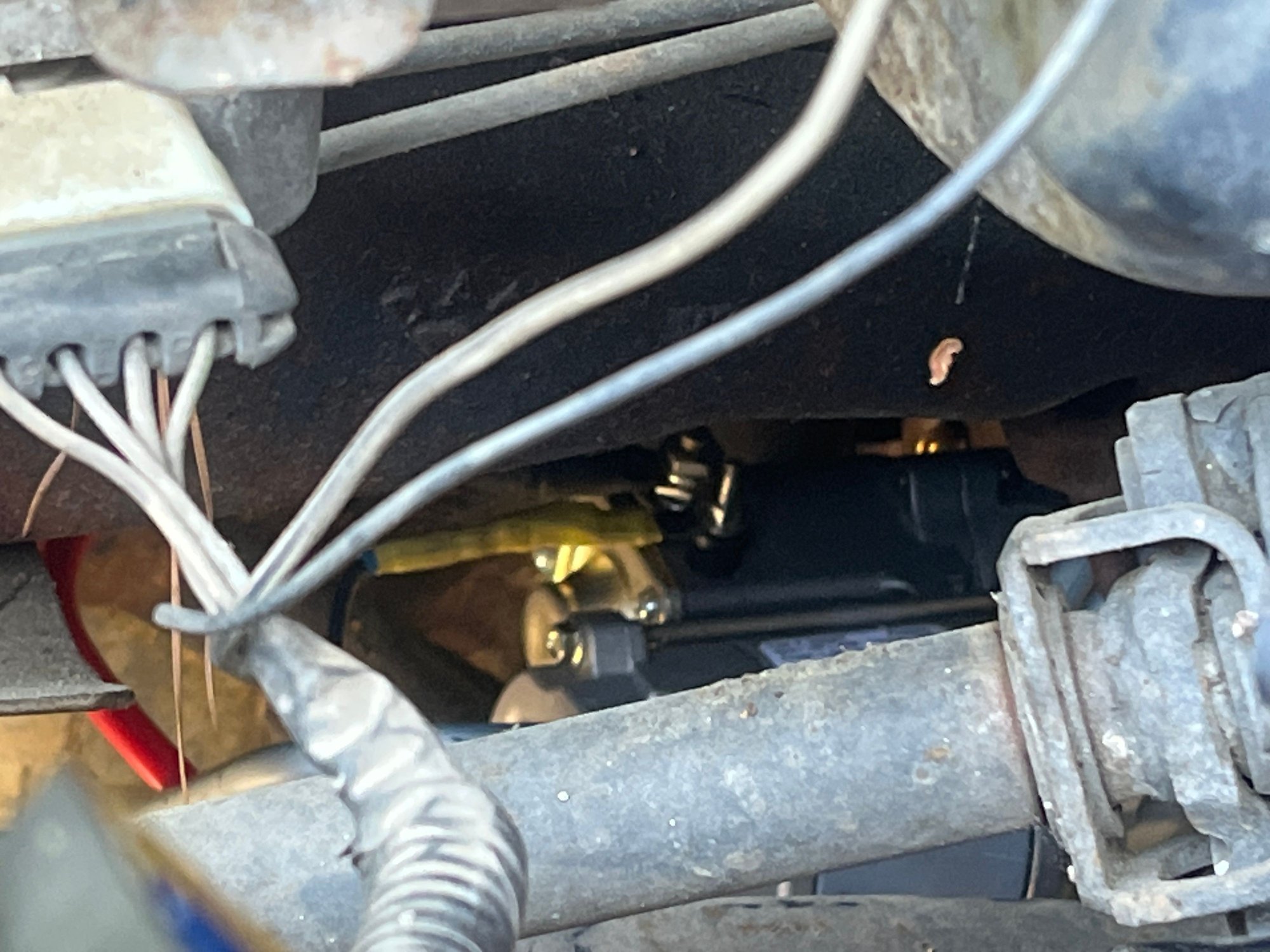

OK so pin 80 yeah 87 to the ignition wire the small wire that goes to the starter I have power going there. I have power from 30 and 86 and 87 when the ignition is on so I guess I’m getting power to the starter and I’m getting power from the switch to the relay, but it’s not cranking the double check the fuses and the relays. They are all good. I even checked to make sure that the neutral safety switch is plugged in correctly and that I have continuity there throughout the wires. Everything’s plugged in and brand new starter. It’s a solid wire essentially I replaced the ignition wire from the starter to the battery to the fuse box because that one was kind of dingy. I’m getting power there. I’m just I am just lost with why is it not starting essentially and what it can be so I am double checking everything. I have the fuse box essentially pulled apart to double check everything on that.

So I have everything pulled apart I have power going through the new switch or new connector I have for the ignition switch from the fuse power and the battery. I know that that has power. I’ve checked it several different times power from the relay to the connector I have power when I turn the key I get power and on pin I believe 86 was one tested on with the key on and key off. I get power respectfully if it’s on versus off and I’m just lost for words I mean, I can. I can hook up with a screwdriver to the starter and make it jump, but as far as it starting from the connector from the switch and inside, it’s nothing there’s no power going to it. It seems like kind of cut up the harness, not the connectors, but the wire loom to see each wire to make sure I’m tracing the right wire and I’m just stumped
